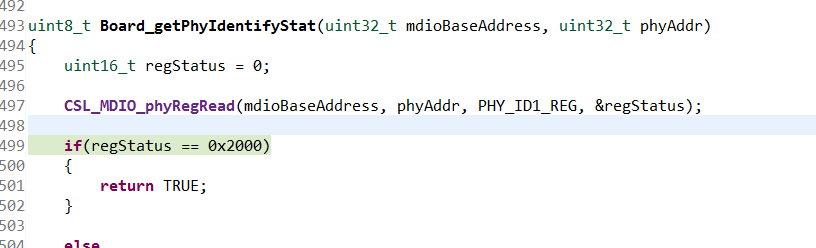

    It looked you were porting the PRU-ICSS with a different PHY. We have a note you can take a look: www.ti.com/.../spracc8.pdf
    When the MDIO fails to access PHY_ID1_REG (register 0x02) with host API, for example, Board_getPhyIdentifyStat(), it usually implies that the PHY is not reset correctly or the PHY address is not configured correctly. The reset method may vary between TI and customer boards as a result of using
    different GPIOs.

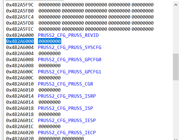

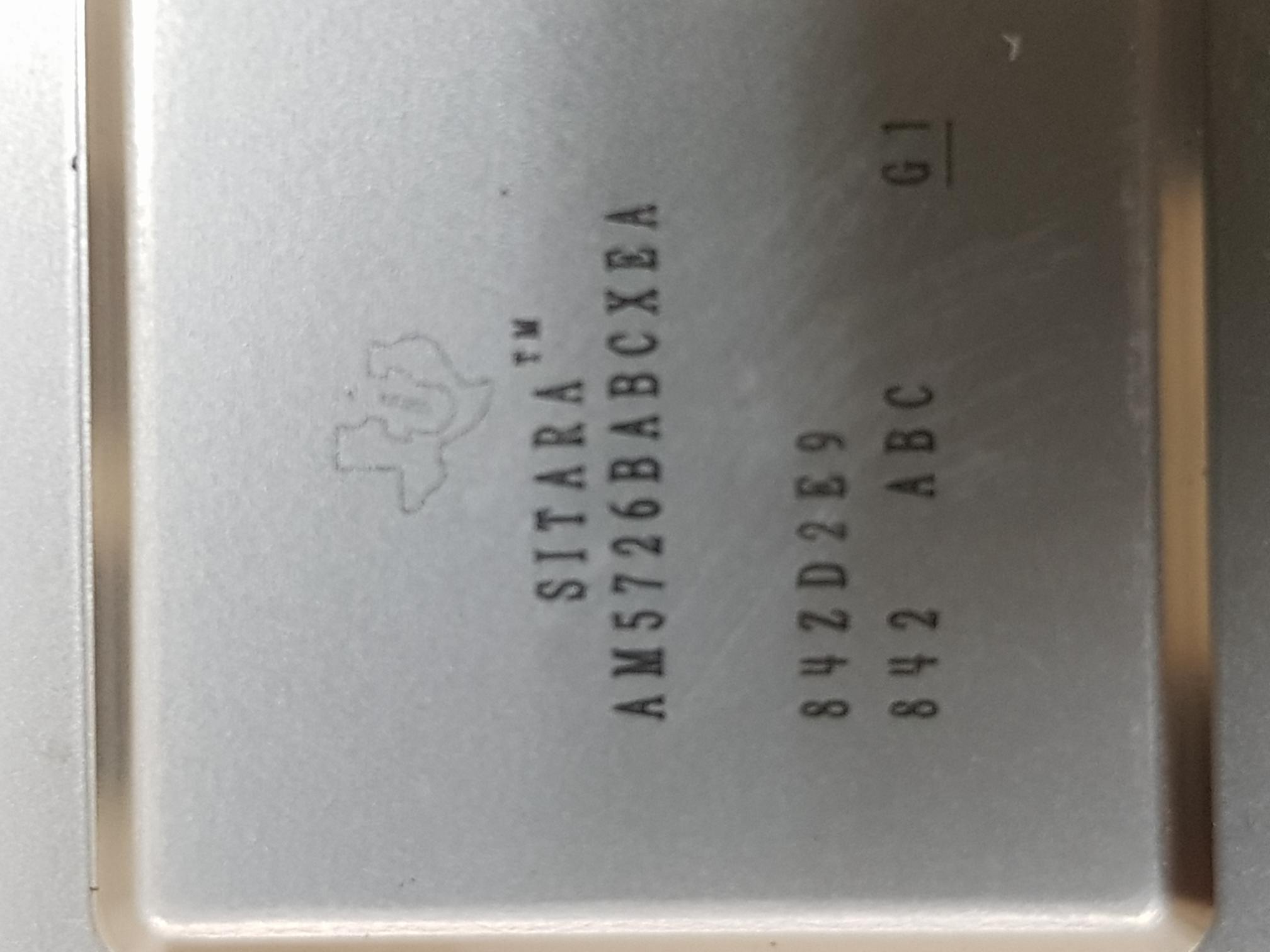

  • Hi
    I'm back to EtherCAT integration.
    I managed to narrow down the problem.
    access to address 0x4B2A6000, (PRU revision?) sometimes crashes, sometimes returns 0.
    If it does not crash and return zero, program get stuck in PHY identification.

    If I read the same address on idkAM7528 I get 0x47000201
    Line marked in bold above.
    What can It be?
    Rasty
  • Rasty,
    What the software release for this code? Let me check my colleague support PRU-ICSS.
    Regards, Eric
  • Hi
    We use exactly the same software.
    Looks like PRU is not there or memory map changed.
    Best regards
    Rasty
  • C:\ti\PRU-ICSS-EtherCAT_Slave_01.00.06.00
  • This problem with missing PRU is solved. Clock was missing. Many thanks to Carlo for hint.

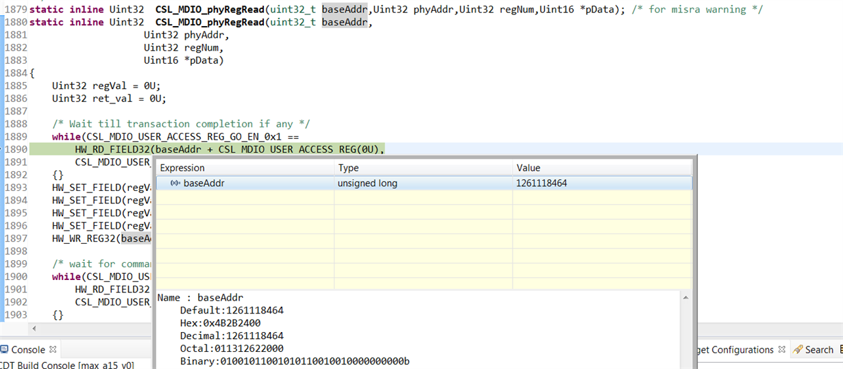

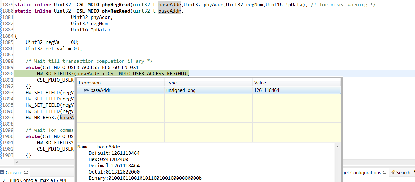

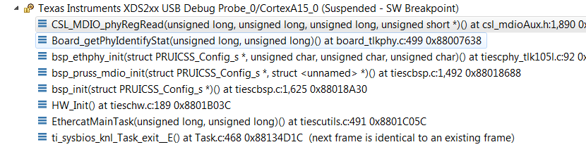

    Next problem in CSL_MDIO_phyRegRead
    Endless loop in:
    /* wait for command completion */
    while(CSL_MDIO_USER_ACCESS_REG_GO_EN_0x1 ==
    HW_RD_FIELD32(baseAddr + CSL_MDIO_USER_ACCESS_REG(0U),
    CSL_MDIO_USER_ACCESS_REG_GO))
    Question: pin map is different from Evaluation board: We generated a new boardPadDelayInit.c with TI Pinmux tool.
    What is about: PRUICSS_pinMuxConfig(pruIcss1Handle, 0x0); // PRUSS pinmuxing ?
