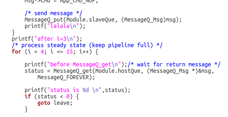

Hi
I have followed the same steps as in the video training guide. I am using ti-processor-sdk-linux-am57xx-evm-05.00.00.15 and  RTOS version 05.01.00.11  I observe the issue on my side:

before MessageQ_get
When executed, "sending message 3" gets stuck
The printed information I added myself is as follows:
I found the problem in "MessageQ_get".  I don't know why "MessageQ_get" can't receive messages
  • Hi, Chandler,
    From the description, it seems to me that you are not using the prebuilt images, but built your own. If that's the case, please don't mix match the Linux and RTOS versions. Please try again using both SDK 5.1. When you build the images, do you use high level build? Try follow the steps in IPC Quick Start Guide when building the images.
    You can try with the prebuilt images in /usr/bin/ipc/examples/ex02_messageq in the filesystem of the released package to set the expectation.
    Rex
