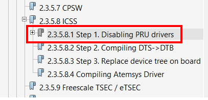

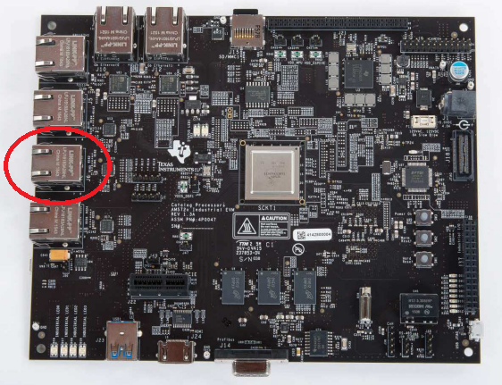

  • Hi Hungwei,
    I think you are trying to use Port1 on AM5728 IDK. However, just FYI, only PRU-ICSS 2 is pinmuxed on AM5728 IDK. In other words, please try Port3 or Port4. In the board this corresponds to PRU2 Eth0 (J6) and Pr2 Eth1 (J8). This should fix link detection.
    Also, it seems you are trying to use original PRU drivers along with EC-Master link layer. This won't work. Please refers to EC-Master_ClassB.pdf on how use correct .dts
    2.3.5.8.1 Step 1. Disabling PRU drivers
    In the following SDK subdirectory you find all device tree source files (.dts) and compiled versions (.dtb):
    /board-support/linux-rt-4.9.59+gitAUTOINC+273202a0d3-g273202a0d3/arch/arm/boot/dts
    Normally, board is booted up from am572x-idk.dtb/am335x-icev2.dtb, but TI has already prepared am572x-idk-pru-excl-uio.dtb/am335x-icev2-pru-excl-uio.dtb that better fits our needs. It already excludes most of the PRUSS drivers and we need just to make some little modifications to make it working.
    As we mentioned before, here is a quick and easy way to disable necessary drivers, that should be used only for demonstration purposes, but is is not best one.For your real world system it is better to make a copy of the am572x-idk-pru-excl-uio.dts/am335x-icev2-pru-excl-uio.dts file and then add it to the makefile script to build always your own .dtb file.
    Please let me know if you see this chapter in your documentation, if now I will upload .pdf here.
    thank you,
    Paula
  • Hello Paula,
    Actually, I have tried J6 and J8 as I remembered, but none of them works.
    I have followed the chapter 2.3.5.8.1 from v3.0.1.18 doc. and used am572x-idk-pru-excl-uio.dtb but the link detection issue still happens.
    Hungwei
  • Hungwei, could you please try to run below:
    ./EcMasterDemoEval -auxclk 2000 -t 10000 -v 5 -f eni_disableLRW.xml -icss 4 1 m am572x-idk. I think you are using 1
    Let me know if this helps with the link detection issue. More details on parameters can be found in ATEMDemoConfig.h. You can search for "SOC_AM572x" or for "LINKLAYER_ICSS"
    thank you,
    Paula
  • Hello Paula,
    ./EcMasterDemoEval -auxclk 2000 -t 10000 -v 5 -f eni_disableLRW.xml -icss 3 1 m am572x-idk
    I changed to use 3 for J6 and now it works! Thanks a lot for the help.
    Hungwei
