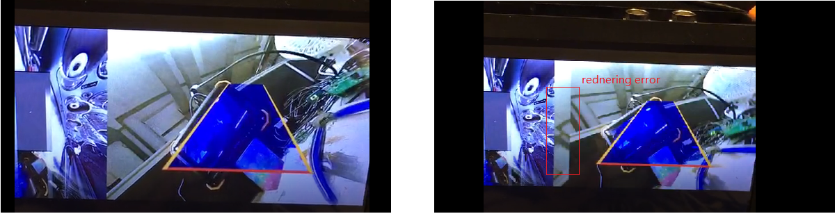

Our product runs well with 60000 triangle,and the fps is 16.
But when we render 600000 triangles, some strange rendering images comes out
I want to konw what will casue such kind of image, as I konw too much triangles will only effect the fps, but not the rendering result.
  • Another info, I let the application sleep 50ms after eglswapbuffer, the tearing will not happen

    more info:
    I call eglswapinterval(2), and the rendering image sometimes without tearing, But using eglswapinterval(0), the frequency of tearing is even higher .
    But with 60000 triangle we do not find tearing so far.
    So is that true rendering too much triangle will cause rendering error.

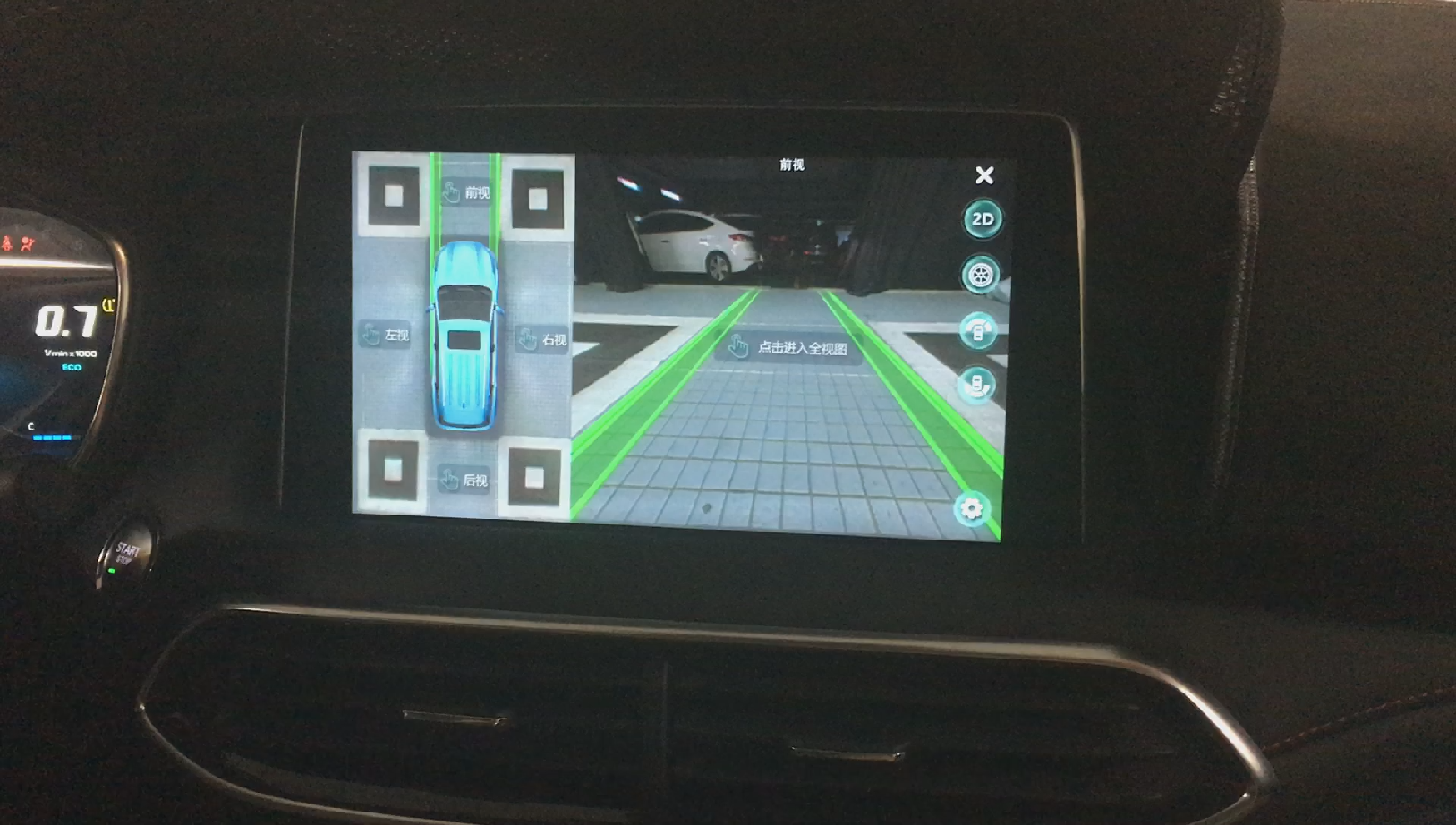

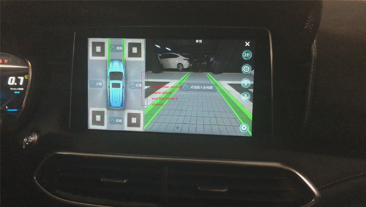

    Another problem with triangle numbers:
    When changing the rendering triangle number, the rendering result will slightly transform
    The first frame we draw a full screen quad to show an UI
    The second frame we draw 60000 triangle to show the surround view and other 3D model
    The third frame we do exactly the second frame do
    But the second frame is wrong, the image which contains two rendering region, the left region  is narrow  which is not expected.
    And the third frame is correct, the left region is larger than the sceond frame. Then we keep rendering, all the frame is correct after second frame
    To create regions, we use glviewport api.
    Is this problem may be the same reason?

    Purely at the GPU level, the screen tearing should not happen because of number of triangles.
    The tearing problem mainly occurs due to a lack of sync between producer and consumer. There are two possibilities here:
    1. Display driver has already queued up the frame for display while GPU is still rendering the frame. GPU-DSS sync issue
    2. Number of triangles exceeds GPU limits. CPU starts rendering some of the triangles. CPU-GPU sync issue
    #1 is more of an application design issue. Check how application synchronizes the render thread vs display thread. The display thread should be triggered based on GPU render completion. It cannot run asynchronously on its own at display refresh rate.
    #2 can be checked through PVRTune. Look at CPU vs GPU load on PVRTune for lower vs higher triangle count.
    It should be possible to create a simple OpenGLES application to demonstrate the problem. It does not need to have the whole development workflow. TI needs a sample application showing the problem on TI EVM before we can debug it.
