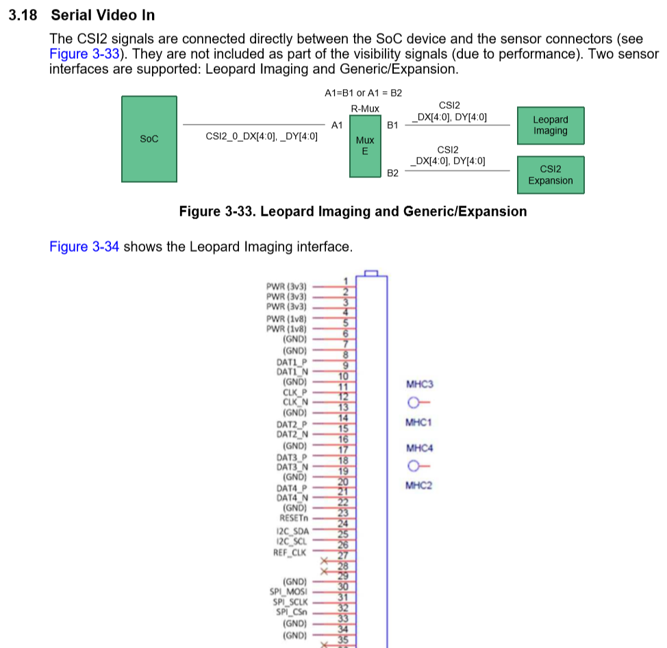

TDA3XEVM: Which Lepard Imaging camera do I connect to LI Camera connector for Parallel Video Input ?
Part Number: TDA3XEVM
My usecase is:  UC_iss_capture_isp_simcop_display
I have Leopard imaging camera part number LI-CAM-OV10640-MIPI connected to CSI2 CAM LI Connector.
From computer terminal, I select following ISS Usecase:
1CH ISS capture + ISS ISP + ISS LDC+VTNF + Display
With this selection, capture and display works fine.  I didn't make any code changes.
Does TI software support one of Parallel capture sources?  See attached.  If yes, will capture and display work without making any code changes?
Do I connect one of these parallel capture sources to LI Camera Interface?
Which Leopard Imaging camera can I connect to Parallel Video In Leopard Imaging Interface?  Is it connector labeled "LI Camera" ?
Do I need to change any board settings to select VIN1A or VIN2A ?
The user guide talks about CPLD.  What is the role of CPLD in parallel video?  Does parallel video go through CPLD to SOC ?
Amer

    There are Two LI ports?
    1) CSI2 CAM LI port. I have OV10640 camera connected. This is serial port?
    2) LI CAMERA port. Is OV10640 camera supported. Is yes, can I connect same OV01460 camera that is connected to CSI2 CAM LI port. Or is there a parallel version of OV10640 camera? This is parallel port?
    Amer
  • Amera,
    1, This is not serial port, this port is used for the CSI input
    2, this port is for parallel input, but with LI connector.
    Earlier, there were two sensors supported OV10640 parallel output and OV10640 CSI output. Parallel output is supposed to be connected to LI camera input and CSI output to CSL2 CAL LI port. But now only Ov10640 CSI output on CSI2 Cam LI port is supported. Please dont mix them as it can potentially damage sensor board and sensor.

  • OK.  Does CSI stand for Camera Serial Interface?
    Are there Four differential raw video signals?  Red, Green, Blue?  What's the Fourth differential signal?
