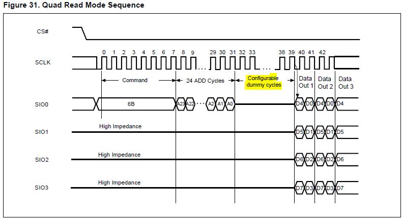

Hi all,
Souce :
PDK_INSTALL_PATH\ti\drv\spi\test\qspi_flash\src\Flash_S25FL\S25FL.c
We usually think that dummy reads are inserted before "data read",
In this program, dummy reads are inserted before "Write Address".
Is this a mistake in the program?

    I can confirm that the issue you are reporting does seem to be a bug in the code that is not exposed since the dummy bit configuration is not used in the test code. If you are looking for correct implementation of QSPI flash test code that does read and write operations, then I would recommend that you look at the flash writer code in the the SBL/boot package provided here:

    Yes, I have confirmed with the development team that this is a bug in the flash code but this only impact if you want to use fast Read. Can you confirm that you need fast Read support that is impacted by the insertion of these dummy cycles?
