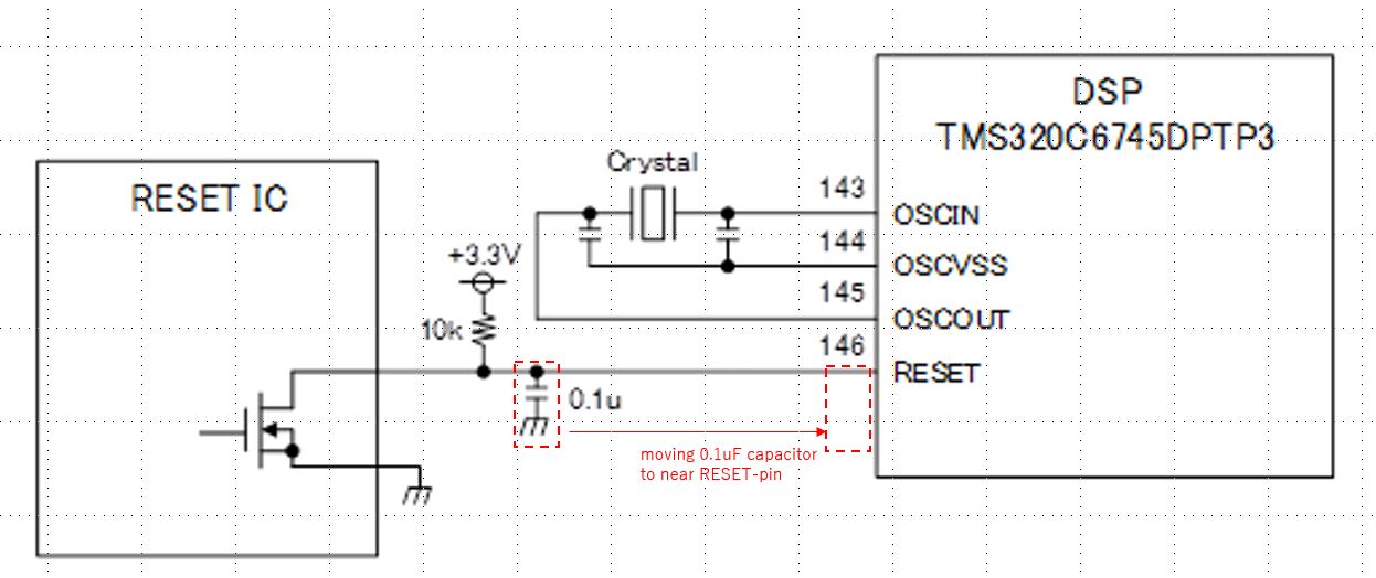

Our customer sent us an question about reset of TMS320C6745DPTP3(QFP-pkg).
They found to fail booting in 11 boards of total 1200 boards.
- After they moved 0.1uF capacitor to near RESET-pin following the wiki, they found to success booting.
   http://processors.wiki.ti.com/index.php/OMAP-L13x_/_C674x_/_AM1x_Schematic_Review_Checklist#General_Recommendations
   The wiki said "A useful tip is to place a 0.1uF cap near the reset pin to help avoid ESD-induced resets."
- They also tried to probe the RESET-pin by oscilloscope to 11 NG-boards.
   But they cannot see fail-waveform.
   Because the 11 NG-boards success to boot when oscilloscope probe touched to Reset-pin.
Question:
    - Are there same experience?
Their assumption is "Reset-waveform captured some noise from next OSC related pin is improved by moving 0.1uF capacitor to near RESET-pin" like below.
If there are any comment, please tell us.
    The scope probe introduces some capacitance on the reset line, and when you probe near the DSP it is enough to get the device booting. Their assumption "Reset-waveform captured some noise from next OSC related pin is improved by moving 0.1uF capacitor to near RESET-pin" is correct.
    Please follow the Datasheet & Wiki recommendations.
    Yordan
