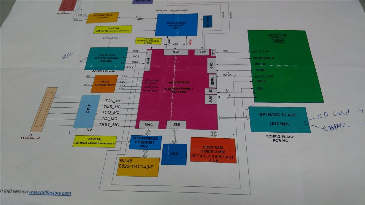

    Now we want to modify the source of this dmatest application in which
    1. we will specify location of a file or array of data to be moved using dma .
    2. Transfer that file/data using dma between FPGA and AM335x processor.
    3. Display its throughput after the completion of transfer.
    Please refer the figure below .
    Please help me in this regard as I am new to this.
    Thank You.

  • I want to clear one thing from you. This DMA Test performed between processor and FPGA or within processor's memory only?
  • It is done all within DDR as this is a generic test that should work on any board. Customizing it to work with a specific set up is up to the developer and the system they are working with.
