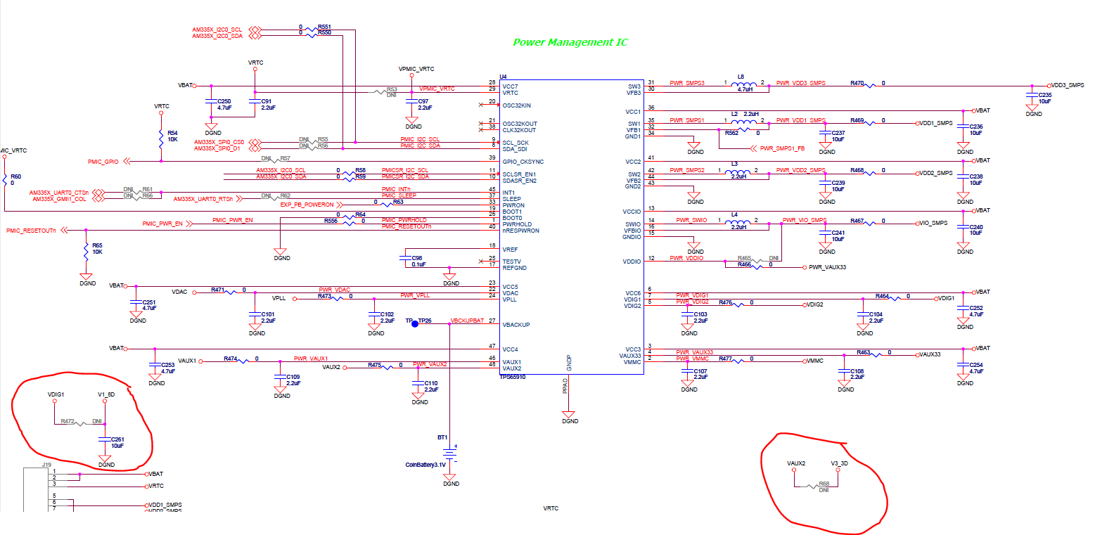

I have a need for booting only the base board of the TMDXEVM3358 eval module. I want to debug a GPMC connection to a different FPGA and this would require access to the base board without the daughter board and LCD board. I see in this previous thread (e2e.ti.com/.../157350 that someone had success with booting by using a jumper on R68. I notice that R472 should probably be connected as well (both jumpers shown on base board below). Both of these jumpers connect the 3.3V and 1.8V supply on the base board to the PMIC as opposed to the regulators on the daughter board. In theory this should be sufficient to boot only the baseboard but I'm wondering if there are any concerns with this. Are there any known concerns, issues, or other modifications that need to be made in order to boot only the base board?
Thank you,
