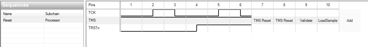

    I have tried to change the ID in the BSDL file (pretend to be a file for the newer silicon revision) but it did not work.
    Patrick

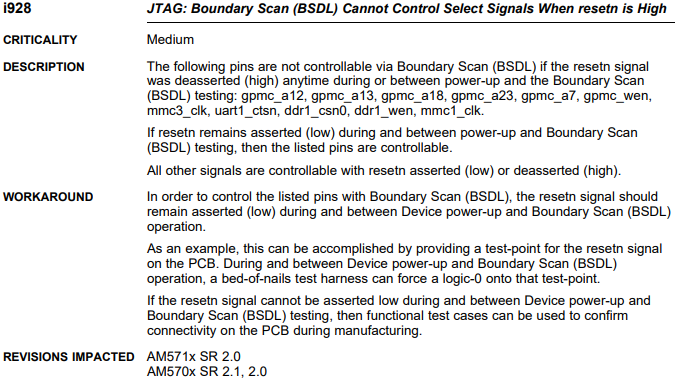

    All else is the same. What is "not working" in your situation -- what kind of issue are you seeing?
  • Ahmad,
    Thanks for the information. I have exactly did the same change in the BSDL file. We work with XJTAG boaudary scan tools. The chain debugger tool tells me that it is unable to count the number of devices but is able to read the ID code (0x1B9BC02F) out of the device. Also the debugging tool was able to calculate the exact IR length (6). Attached is the output of the debugging tool. Because of this behaviour I think the JTAG chain connections are ok. I have to mention that I have not connected the "RTCK" signal yet because clock frequency is low (1MHz).
    Patrick

    Yes, I'm in constant contact with XJTAG. They supplied a solution with a special reset sequence. This workaround allows me to use the Boundary Scan with the AM5716 at the moment.
    The Problem is that to be able to apply this special reset sequence one needs to have a valid licence for an other software package from XJTAG. We only have a demo licence until 11th of December 2018.
    So we still need to know what the exact (smallest) Reset sequence must be to be able to use Boundary Scan with AM5716. If it needs only a few steps we might be able to do it with the software package we have a valid licence.
    What the support engineer from XTAG has found out so far is that the first switch to the "Sample" state fails. All the subsequent switch to "Sample" state succed. Maybe this information is valuable for you.
    Patrick
  • Hi Patruck,
    Can I get more details on this reset sequence? Is this related to Errata i928?
  • Hi Ahmad,
    No, it is not related to the Errata i928. But what I can say is that I had no problems to control those signals even without asserting the RESETn (pull to low) during and between power-up.
    We have a Pullup resistor at the RESETn pin and this pin can only be pulled low manually.
    About the reset sequence I can not tell you a lot of details as this is programmed by XJTAG. What I can tell is that it is made out of four steps (please see picture):
    1. Pull TRSTn low with a rising and a falling edge of TCK, pull TRSTn high with a rising and a falling edge of TCK
    2. Two times "TMS Reset" sequence (pull TMS high while having five TCK clock cycle)
    3. "Validate" sequence (not shure what exactly happens there)
    4. "LoadSample" sequence (send "SAMPLE" command as far as I know, please see file attached)
    After this sequence it is possible to always switch to "EXTEST" without any problems.
    I stille hope that TI can tell me the exact sequence we have to apply to get the AM5716 into a state that it behaves the same way as for example the TMS320F28377D.
    Patrick
