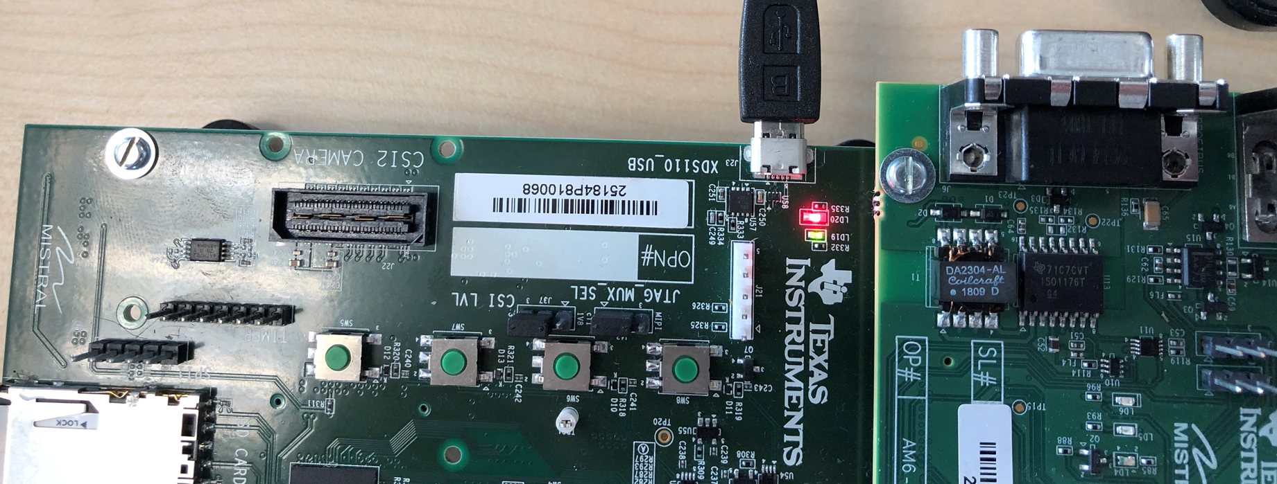

hallo everyody ,
im working on AM65xx/DRA80xM Industrial Development KIT Alpha version, the problem is above on the picture so i cant understand why is on my JTAG-PORT XDS110 Red light althought my debug works.

Hi Anas,
The XDS110 circuit includes a green LED and a red LED.
The green LED is illuminated when the a USB connection is made and power from the USB is applied to the circuit. That is why the green LED will remain on when power is removed from the EVM.
The red LED indicates communication with the XDS110 through the USB. Once you connect to a core, this LED will remain illuminated constantly.
