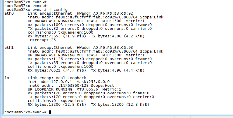

My board is am5728-idk with a LCD.This board is a new one ,so I do some tests and I get some problem.
1.I create a new SD card using default images,  I can go into the matrix desktop successfully and get a IP automaticlly.
the dtb is am572x-idk-lcd-osd101t2587.dtb
2.But after a weekend,  I build a new dtb am572x-idk-lcd-osd101t2587-jh.dtb and add fdtfile= am572x-idk-lcd-osd101t2587-jh.dtb
and I cannot go into the matrix desktop successfully
and even I Unplug the Ethermet cables before I boot the board ,I get the same black desktop

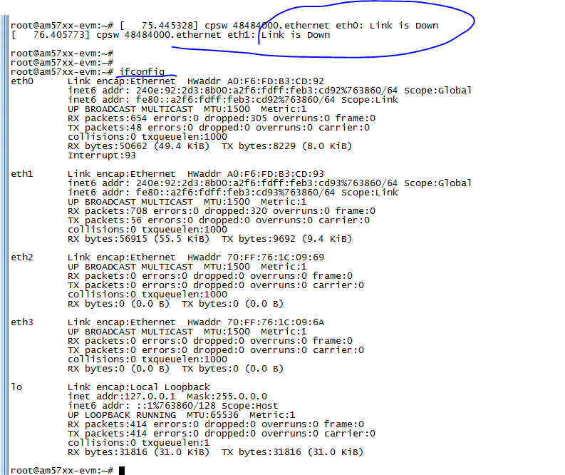

3.then I create the second SD card using default images (the dtb is am572x-idk-lcd-osd101t2587.dtb).
3.1  I can go into the matrix desktop successfully and touch the dsektop with unplug the Ethermet cables. But when I link to internet ,I touch the dsektop with no change and I cannnot get a IP
even I Unplug the Ethermet cables  . I get the same message
3.2 I plug the Ethermet cables ,then I boot my board ,I cannot go into the matrix desktop successfully
4.I try  udhcpc, I always get "seding discover..."
so  what should I do ?
