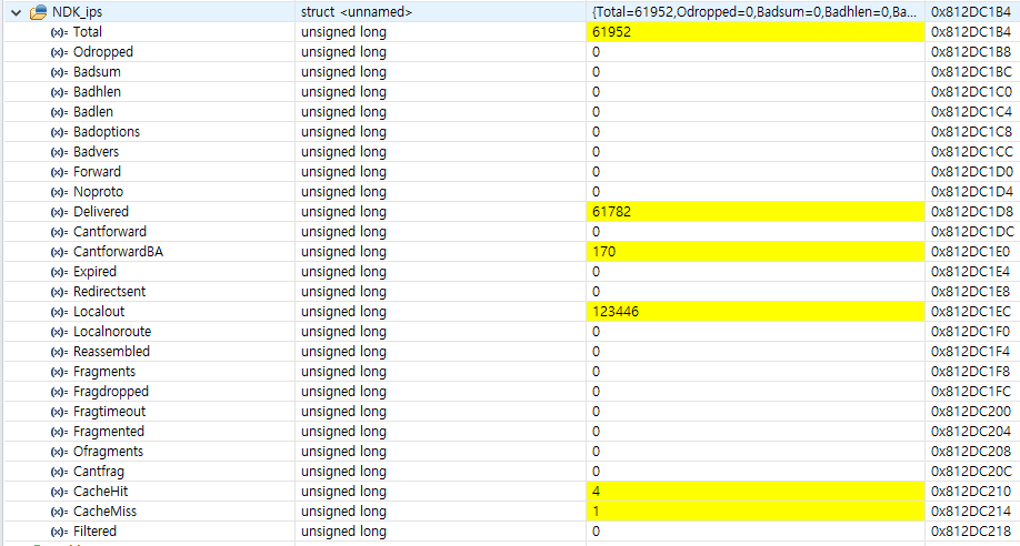

    Thank you for your reply!
    Here's the capture of NDK_tcps, NDK_ips before and after error.
    NDK_tcps before error.
    NDK_tcps after error.
    NDK_ips before error.
    NDK_ips after error.
    I see that with NDK_tcps
    RexmtTimeout
    SndRexmitPack
    SndRexmitByte
    RcvDupPack
    RcvDupByte
    are the ones that increased after failure.
    and with NDK_ips
    CacheHit is different.
