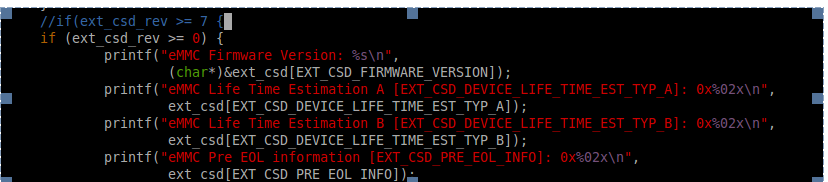

My customer requires eMMC-5 "health reporting" functionality, but AM3352 only supports eMMC-4.3. My customer understands the high-speed mode limitations of eMMC-4.3 vs. eMMC-5 and is fine with it. However, they still require health reporting. This appears to be just a response back from the eMMC device. Does this capability exist in any MMC utilities that are currently included in Processor SDK?
There is an open source package called mmc-utils which currently is not in the SDK. Here is the link:
https://git.kernel.org/pub/scm/linux/kernel/git/cjb/mmc-utils.git/
