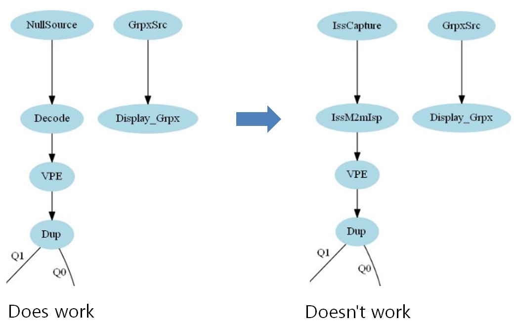

Hi All,
I would just like to change the input of TIDL_OD usecase from NullSrc link to IssCapture link. The camera uses the OV2775 Sensor (TIDA001130).
so I changed tidl_OD UC to capture camera image by referring ISS UC (1: 1CH ISS capture + ISS ISP + ISS LDC+VTNF + Display) as below.
Then I generated uc released files by using vsdk and changed chains_tidlOD.c (chains_tidlOD_SetAppPrms, )
Now I just use AVM camera for testing purposes and will later connect a narrow angle 2M camera with a non-enabled isp.
here is may question
1. Is my usecase for capturing via camera properly configured?
    If not,  could you suggest me proper chains ?
2. when I execute above tidl_od uc , I can't see any image on video instance.
   Can you advise me on what is wrong?
   pls, refer related debugging log as below.

    Please dont use ISS capture link with TIDL links as tidl does not support real time processing.
    Please refer to any usecase with ISS capture.
    Anuj

    TIDL algorithm needs to be trained for different inputs.
    So if you use ISS capture then your final output or the detection of object will not be proper.
    So i suggested not to use any kind of capture link as the same has not been tested.

    I am not saying there is no way to connect a camera with TIDL usecase.
    But if you connect a camera then the final output of tidl will not be proper.
    If its fine for you the i can guide you how to modify TIDL usecase to receive input from camera.

    Can you first try the below usecase and check whether it works properly or not
    vision_sdk\apps\src\rtos\usecases\iss_monochrome_capt_isp_display
    Anuj
    Please do following modifications in file app_util_iss.c:
    pPrm->channelParams[chId].enableOut[
    ISSM2MISP_LINK_OUTPUTQUE_IMAGE_RSZ_A] = 1;
    ISSM2MISP_LINK_OUTPUTQUE_IMAGE_RSZ_B] = 0;
    ISSM2MISP_LINK_OUTPUTQUE_H3A] = 0;
    ISSM2MISP_LINK_OUTPUTQUE_H3A_AF] = 0;
    IssM2mIsp link has 4 outputs but you are using only one, so you need to disable other outputs.

    It turns out that  iss_capture link does work fine as attached log(

    but I still can't see any image on video instance.
    I thinks it was related to sensor frame-rate by seeing the log.
    so, I want to change fps to 15 because each eve process algo_tidl with performance 8 frame per sec.
    here is my question
    1. If what i think is right, how to change fps to 15.  If it is wrong, could you please advise me what is wrong?
    2. Is above my usecase for capturing via camera properly configured?

    From the log attached i can see that capturing from camera is working fine.
    Even vpe is dropping frame that will not be any issue.
    As in original TIDL_OD usecase we run at 30 fps but vpe drops at a rate of 6 FPS on TDA2xx.
    As i earlier suggested to you with camera input TIDL_OD output wont be proper.
    From the log i can see all the link are running fine and data path is ok.
    Anuj
