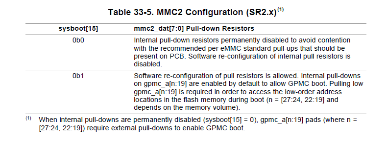

Hello, I believe that the description for bit 15 of CTRL_CORE_BOOTSTRAP is incorrect for AM571x SR2.x (this is on page 4298 of SPRUHZ7H):
SR2.x Only:
Permanently disables the internal PU/PD resistors on pads
gpmc_a[27:24, 22:19].
0x0: Internal pull-down resistors are enabled
0x1: Internal pull-down resistors are permanently disabled
Am I correct that the descriptions of values 0 and 1 should be reversed?
