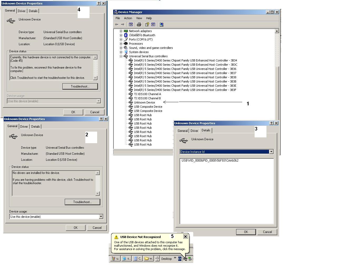

  • Dear Christina hi,
    This post is quite old but I hope you can see my question, I have a problem with USB with c6748 DSP. I have a custom board with the present DSP really not that different from the EVM6748 as far as the DSP is concerned.
    I am trying to run a USB example (any example) using the BIOSUSB 01.10.03. I also have winXP, CCS4, BIOSPSP 1.30.01, DSP-BIOS  5.41.03.17
    Code Generation Tools 6.1.9, EDMA 3 LLD 01.11.02.05.
    The problem I see is that when I load the program I get "USB device not recognized" and the device is shown as unknown. In one example I did set the ID you mention to device but no luck. I've posted snap shots of the problem, you can see that the VID AND PID show zero.
    can you help?
