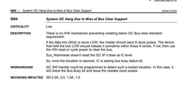

 I was looking through the errata issue for TDA3x SoC and I found this issue.
Does the WORKAROUND I2C SW handler already handled by starterware or do we have to handle it in the system ourselves?
We are using starterware 01_08_01_24
http://www.ti.com/lit/er/sprz425e/sprz425e.pdf
  • Hi Myat,
    I am not starterware/i2c expert, but I see in file "starterware_01_08_01_24/i2clib/lld_hsi2c.c" that
    there is function "lld_i2c_recoverBus()" which check if SDA or SCL is stuck low and sends 9 clock pulses.
    Can you check if that is what you look for?
