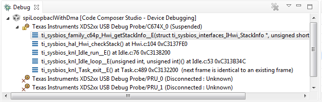

    Capture of Debug after addition of spi dma in pdk.
    Thanks & Regards,
    Bhargavi Ale.
  • Hi Sahin Okur,
    I forgot to inform that, edma transaction is working only once without any above chances in pdk and after one transaction control got stuck at semStatus = SPI_osalPendLock(object->transferComplete, object->waitTimeout);. I was attached same project in my previous post.
    Please, let me know any idea on the same issue.
