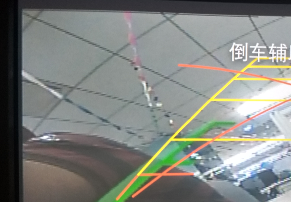

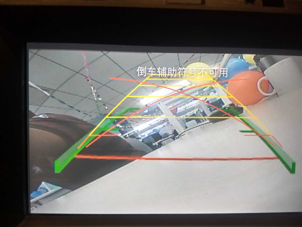

Hi All ,
I am capturing BT-656 streams from decoder ADV7182 through Slice1 PortA of VIP parser through VPDMA. The frames are captured properly,but the every alternate lines in the frame looks missing.This results in pixels missing in the every alternate lines(Black lines on the roof) ,which results in not a smooth picture. What is the real cause for this issue.
We are using Vision SDK based driver in sysbios in ( IPU1-cortex-m4 ) for DRA74xx .
Have attached the original and zoomed version of the same snap shot. If close look the the zoomed.png file ,where the straight lines(black lines & on other edges)  in the picture are discontinuous. Can some one let me know how this problem can be resolved.
With regards,
Jeyaseelan
  • Hi Jeyaseelan,
    Could you please check if there is really alternate lines missing? It seems fields are swapped.
    Btw, how are merging two fields for interlaced input? VIP outputs individual fields. are you providing two buffer pointers to the display driver?
    Essentially how do capture two fields and display them on display driver?
    Rgds,
    Brijesh
  • Hi Brijesh,
    Actually as per the driver code , the vpdma list complete interrupt is triggered for VIP1 interrupt line 70 over cross bar 392 ) . i guess this interrupt is triggered on reception of every field. In the ISR, Field_ID component is read from the register "VIP_OUTPUT_PORT_A_SRC_FID 0x48975A20" for source 0 at bit 0 . If it is read as odd field ,then DDR start buffer is adjusted to buff+ 720 for Y and UV and vpdma list is again reconfigured for next field capture for this new address. Have attached the code snippet below.

  • Hi Jeyaseelan,
    Can you try swapping buffer addresses for both even and odd fields?
    From the picture above, it looks like field swap.
    Brijesh
  • Hi Brijesh,
    Thanks for the support . I have re-arranged these lines adjusting target start of memory by checking the Bit-1(current field) of register "VIP_OUTPUT_PORT_A_SRC_FID 0x48975A20" .Before it was tested for Bit-0(previous field).This resulted in swap of lines. Now the lines are are properly and the picture looks clear.
