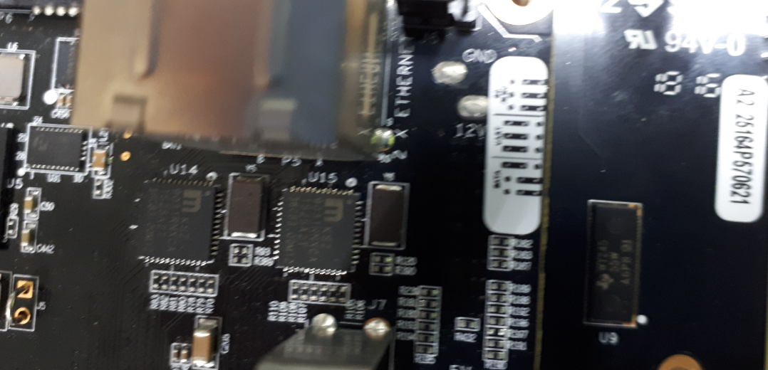

our board is as follwing. GP EVM verion is beyond A2.  It is connected the J3/J4/J6 to [1:2] for serial boot, and is connected the J5.

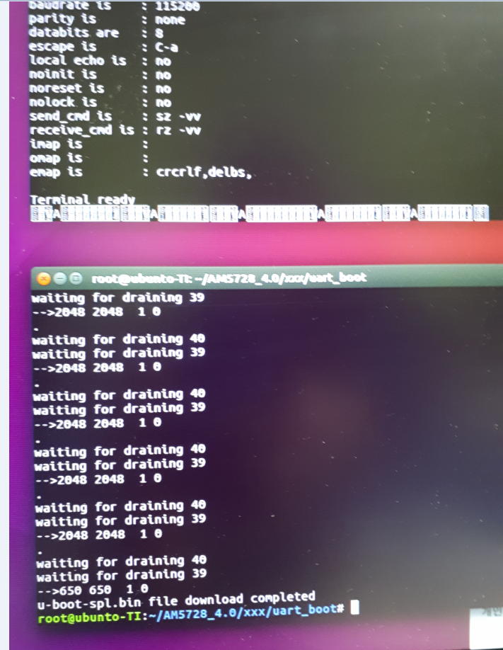

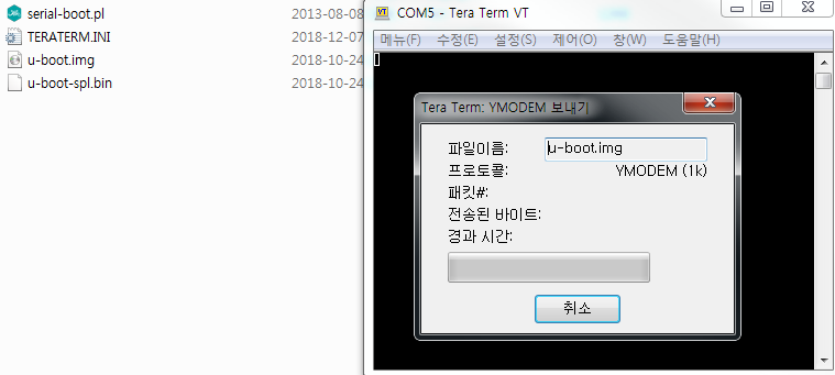

We sucess it on window as follwing below it.
perl serial-boot.pl -p com5 -s c:\Perl\u-boot-spl.bin -d 1
we don't see "CCCC" at Tera Term on windows. Anyway, we failed uploading u-boot.img on windows. It don't send any bytes.

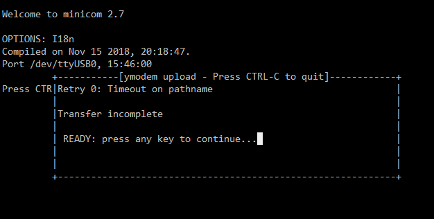

We think that window don't support uart-boot. and then tryed to boot uart on uBuntu.
perl ./serial-boot.pl -p /dev/ttyUSB0 -s u-boot-spl.bin -d1 -t40

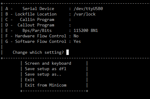

our minicon settings is as below it.
we don't see "CCCC" at minicom  on uBuntu. Anyway, we failed uploading u-boot.img.

  • hi.
    we review the url as you indicate and retry it. we have no difference with the url.
    first, we wonder why we don't see "CCCC" at Tera Term or Minicom. our image have no problem(it is surely compiled with CONFIG_SPL_YMODEM_SUPPORT) and console settings is surely "115200 baud 8 stop bits no parity".
    we tryed it with no - Software Flow control.
    second, Y-modem with u-boot.img transfer is always failed. What is the problem ?
    Thanks a lot.

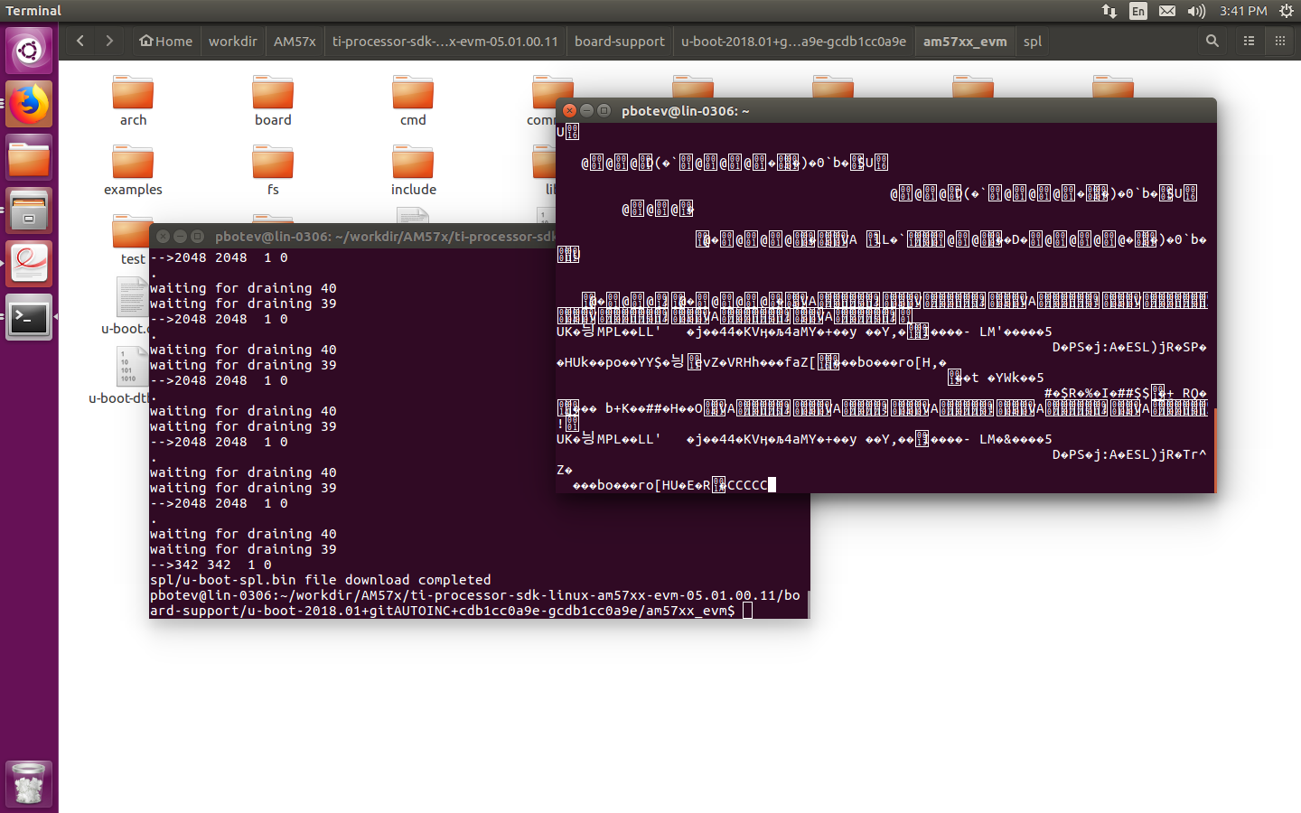

  • Joonho,
    I just tested on my AM572x EVM (rev A2) and I am able to boot the EVM from UART according to the instructions provided in the e2e thread I have sent to you in my previous reply.
    Please double check the below points:
    1. Modify u-boot/configs/am57xx_evm_defconfig file as below and build new u-boot-spl.bin and u-boot.img
    + CONFIG_SPL_YMODEM_SUPPORT=y
    2. Open two consoles, one within u-boot/am57xx_evm/ folder and one withing your home directory.
    In home directory console, execute "picocom -b 115200 /dev/ttyUSB0" and just monitor this console for now
    In u-boot/am57xx_evm console, I execute the below command:
    u-boot-2018.01/am57xx_evm$ perl serial-boot.pl -p /dev/ttyUSB0 -s spl/u-boot-spl.bin -d1 -t40
    Then I have the below message:
    ----Please reset the Board NOW (timeout=40 sec)----
    Then I power on the EVM and the u-boot-spl.bin transfer starts. At the end I have the below message:
    spl/u-boot-spl.bin file download completed
    At that time, the home directory console I start to see CCCCC stream. See the print screen attached:
    3. In u-boot/am57xx_evm console I execute the below command:
    u-boot-2018.01/am57xx_evm$ sx -kb --ymodem u-boot.img < /dev/ttyUSB0 > /dev/ttyUSB0
    Sending: u-boot.img
    Bytes Sent: 998784   BPS:10035
    Sending:
    Ymodem sectors/kbytes sent:   0/ 0k
    Transfer complete
    And I see u-boot.img is executed in the other console:
      ���bo���ro[HU�E�R�CC(STX)/0(CAN) packets, 5 retries
    Loaded 998708 bytes

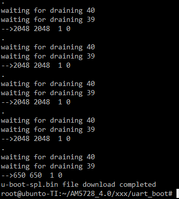

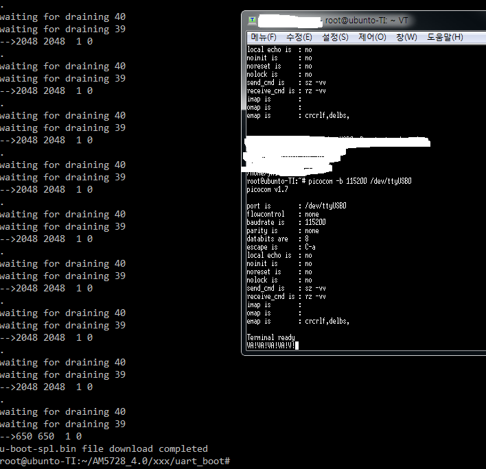

  • Hi.
    Thansk for your kindly answer.
    we follow that you say. but, we  have same error( we don't see "CCCC").
    we attach our print screen(console display on Ubuntu,  I think that you don't see console display very well, so we send cleared print screen.)
    At two print screen, When we send u-boot-spl.bin, Monitor of picocon displays "VA!:".
    also, After we complete sending u-boot-spl.bin, Monitor of picon don't display "CCCC".
    we attath our compiled image and config(tt2.7z : u-boot.img, u-boot-spl.bin, .config, am57xx_evm_defconfig). but, we surely compiled with CONFIG_SPL_YMODEM_SUPPORT.
    we see xyxModem.o and spl_y_modem.o.
    What's the problem ?

  • Joonho,
    I tested with your u-boot-spl.bin file and I observe the same issue on my side, this u-boot-spl.bin is not working properly, I have no CCC stream on my console.
    I am attaching my working fine u-boot-spl.bin file, please try with it:
    https://e2e.ti.com/cfs-file/__key/communityserver-discussions-components-files/791/7750.u_2D00_boot_2D00_spl.bin
    I am using the default u-boot code base, only modified am57xx_evm_defconfig as already discussed.
    Note that this u-boot-spl.bin is based on ti-processor-sdk-linux-am57xx-evm-05.01.00.11/board-support/u-boot-2018.01
    Please try with my u-boot-spl.bin and if successful, you might try the whole flow with PSDK 5.01 and see if you will be ok there.
    Pavel

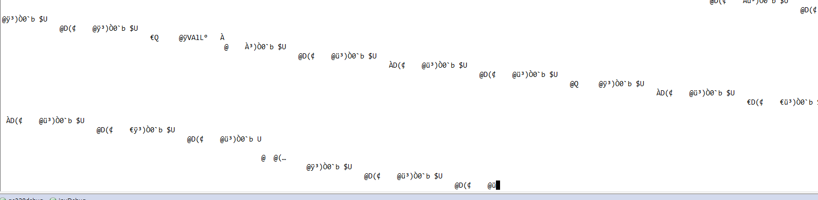

  • Hi.
    we can see "CCC" through 7750.u-boot-spl.bin .
    we have successed as follow it with 7750.u-boot-spl.bin .
    root@ubunto-TI:~/AM5728_4.0/xxx/uart_boot# sx -kb --ymodem u-boot.img < /dev/ttyUSB0 > /dev/ttyUSB0
    Sending: u-boot.img
    Bytes Sent: 854656 BPS:9974
    Sending:
    Transfer complete
    but, we don't see u-boot.img is executed successfully in the other console.
    we can only see unknown characters as follow it.
    €ÿ³)Ò0`b$U
    ÀD(¢ @ÿ³)Ò0`b$U
    @D(¢ €ü³)Ò0`b$U
    €D(¢ € @ü³)Ò0`bU
    @ @Q @ÿ³)Ò0`b$U
    @D(¢ @ü³)Ò0`b$U
    ÀD(¢ @ü³)Ò0`b$U
    @D(¢ @ü³)Ò0`b$U
    @Q @ÿ³)Ò0`b$U
    ÀD(¢ @ü³)Ò0`b$U
    ÀD(¢ @ü³)Ò0`b$U
    ÀQ @ÿ
    We've build u-boot.img with PSDK4.x(ti-processor-sdk-linux-am57xx-evm-04.00.00.04). So this problem happen ?
    Thanks a lot.
