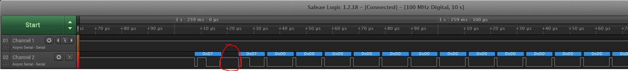

We need to operate two UART instances (instance number 4 & 5) on an AM572x processor in DMA mode in order to achieve transmitting 180 contiguous bytes without any time gaps. Therefore we copied source-code from the TI example project 'UART_BasicExample_idkAM572x_DMA_armTestproject' into our project. The example test case is called 'UART_TEST_ID_DMA_CB'.
Inside our *.cfg file we only did the following (like inside the example project):
/* Load the uart package */
var Uart = xdc.loadPackage('ti.drv.uart');
But we can see that the transmission is not contiguous, which is an indication that we do not send the data via DMA to the Tx FIFO, see below the time gap in a logic analyzer measurement inside the red circle:

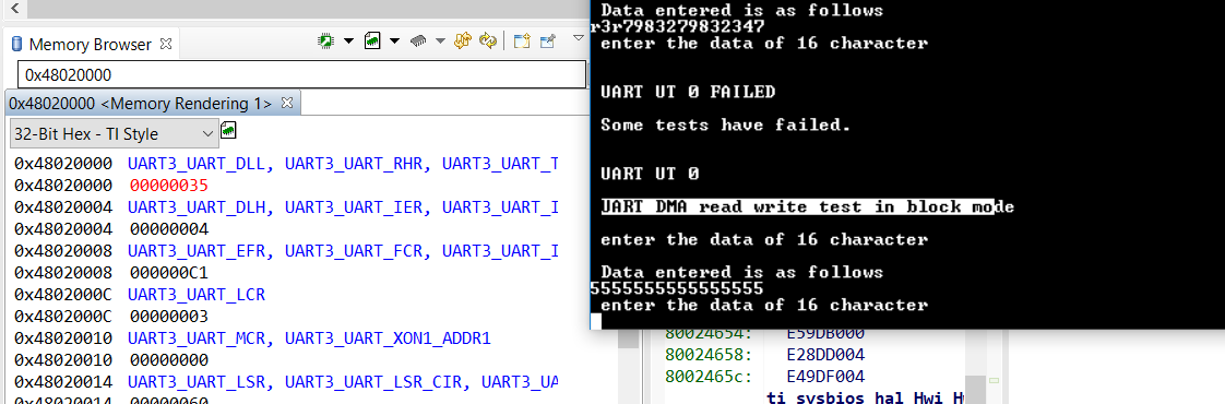

    Thanks for the summary. Are you able to use TI AM572x IDK EVM to test the UART_BasicExample_idkAM572x_DMA_armTestproject with the ti.drv.uart.profiling.dma.aa15fg linked? For now, I assume the Tx is OK, you didn't see the gaps.
    For the UART, the EVM uses the UART3 (1-based) I tested it and I saw it passed the read and write test. E.g, it takes what I typed into UART console and print it out to console.
    In the CCS memory browser, I can look at the offset 0x0 which is RHR register to see what the UART received in FIFO. For example when using a fixed input pattern "555555555555..." I saw RHR with "35" this is ASCII "5".
    If you can verify the EVM worked, then in your own board with only one UART 4, are you able to see the pattern in RHR, or, they are zero?
