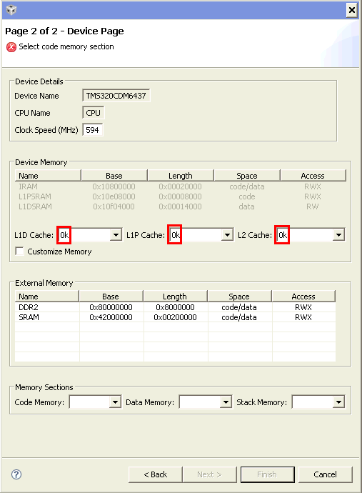

In RTSC platform setting, the default value(s) for L1D, L1P and L2 cache are all zero-K.
If DM6437 has in its internal 32KB L1P, 80KB L1D and 128KB L2 cache, why are they by default as 0 here? If I am leaving them as 0 unchanged (the documents says they are "flexible allocation", does that mean from 0 to their (L1D, L1P, L2) maximum physical size are all OK? ), will the code still work on the EVM?

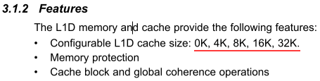

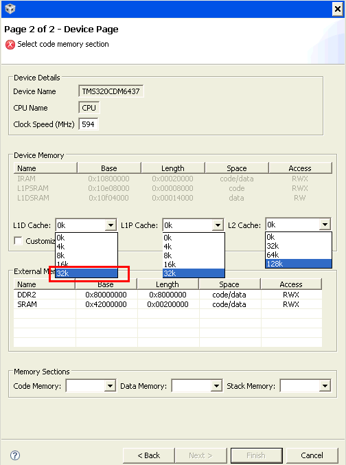

Another setting I have question on is that the drop-down menu for L1D cache allows a maximum of only 32K (byte or bit?), but according to specification DM6437 actually has 80KB "flexible allocation" size. Why here only a maximum of 32KB can be selected?

  • Hi Zheng,
    DM6437 is byte addressable and all the cache sizes shown in the platform wizard are in bytes.
    >If DM6437 has in its internal 32KB L1P, 80KB L1D and 128KB L2 cache, why are they by default as 0 here? If I am leaving them as 0unchanged (the documents says they are >"flexible allocation", does that mean from 0 to their (L1D, L1P, L2) maximum physical size are all OK? ), will the code still work on the EVM?
    The default cache values used in the platform wizard are set to the device cache settings when it comes out of reset. Any real world application will definitely use the cache but you can write programs with the cache disabled as well.
    The term flexible allocation refers to the fact that you can configure parts of onchip memory as cache and internal memory. There are discrete combinations which are supported by the device and the selection really depends on your application usecase.
    You can visually inspect the relation between cache size and corresponding internal memory sections in the platform wizard. For example if you set L1D to 32k the corresponding internal memory section- L1DSRAM - is set to 80-32 = 48k(0xc000). This means that you have 48k on onchip data memory that your application can use. You can configure L1P and L2 caches in a similar manner.
    This is determined by the hardware itself.  Page 8 of the DM6437 data sheet under "on chip memory" specifies that only 32KB of L1D is able to be used as cache.  This is part of the design of the cache controller and is discussed in the 64x+ Megamodule Reference Guide as well (e.g. see Section 3.1.2 Features).

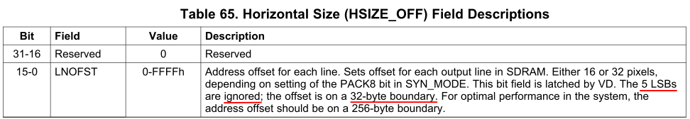

    I am asking this because on page 131 of SPRU977a, VPFE document, the line offset vaue takes only 32's multiples and ignores the 5 LSBs.  Of course this is different from L1D (0, 4, 8, 16, 32) which are 2's power rather than ignoring bits (if we insist on viewing it from the perspective bit ignoring, then left two LSB, but the multiplication over 4=2^2 are still not consecutive numbers (0, 1, 2, 4, 8), so technically l1D increment interval is not purely decided by bits ignoring).

    Dear Amit,
    I am a bit confused. Do you basically mean:
    1. All caches (L1D, L1P, L2) are zero by default. "Platform wizard" won't set them for you automatically.
    2. The user is responsible for changing them to the desired value.
    And can cache information be viewed in linker.cmd or .map file? I checked both files of my program (a "naked" program without BIOS) but did NOT find any "cache" section so I wonder if I have enabled them:

    the increments are discrete (2's power) rather than any arbitrary value between 0 and 32 (13, 14, 15, 17, 21, etc.)?
    Any ideas from the circuit design perspective on why it is like this?
    I think it boils down to the way cache works.  Any given address in memory will map to a very specific location (or locations) in the cache.  The number of places to which it maps is given by the cache associativity.  In order to have "nice" correspondence of a given memory location and its position within the cache you generally want to be able to just extract specific bits out of the address.  Forcing the cache size to be a power of 2 makes this easy/possible.  If you had a weird cache size line 18KB then it would require math to figure out where a given address in memory actually maps into the cache!

  • Hi Zheng,
    Zheng Zhao said:
    Actually, even in projects with BIOS support and although I do have selected (L1D=32K, L2P=32K, L2=128K) cache sizes in the platform wizard, I still cannot find any cache information in configPkg\linker.cmd and the Debug\ .map files. Am I actually using cache then? What's wrong here?
    The RTSC platform is our software abstraction for managing device/board specific configuration. Most often we use it to specify the device clock speed, cache settings and external memory. Software components like SYS/BIOS reflects on these settings and initializes the device. In this particular case the actual cache registers are programmed based on the settings specified by your platform. You will not see the cache settings reflected in a linker command file. You can take a look at the Cache module in SYS/BIOS (navigate to <bios6_install_dir>\packages\ti\bios\family\c64p\  and review the Cache.* files) for more details.
    This was the original behavior but based on similar feedback we have changed our platforms to provide  "reasonable" defaults in XDCtools 3.20.05. Note that in the end you - the application developer - has to decide the cache/internal memory layout that is suitable for your application. If the defaults provided by the platforms we ship in XDCtools are not good enough you can use the platform wizard to create a platform with the desired settings. Based on these settings SYS/BIOS will set the cache accordingly.
    Let me know if this helps.
