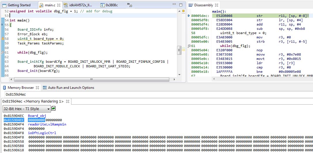

    But they found strange behavior with PCIE integration in EC-Master.
    - They found success to run with CCS loading boot.
    - But they found hung-up(no response) with SD-boot.
    We analyzed detail by single step debug.
    And we found "Board_internalInitI2C()" is SKIPPED
    because "Board_obj.i2cHandle" is not initialized in NG case.
    (please refer attached pdf)

    main()
    step into -> Board_init(boardCfg);
                       -> Board_pinmuxConfig()
                        -> Board_getIDInfo(&id);
                      -> if (Board_obj.i2cHandle == NULL)
                                 { ret = Board_internalInitI2C(); }
    Question:
       Could you tell us how to initialize the "Board_obj.i2cHandle" ?

  • Hi Matusan, could you please send me the password for unzipping CCS project? Maybe via private message?.. In the meantime, it seems something gets initialized differently between GEL file and MLO.. A wild guess, is there any linker command file in CCS properties -> General? if so, could you delete it, rebuild, and test?

  • Hi Matusan, I haven't tested it yet. But, could you delete Linker Command file: AM572x.lds (Properties->general). I faced a similar issue in the past and it was due to conflicting .lds file.

    We found success to run with SD-boot.
    It seems to be solved the problem by "deleting Linker Command file: AM572x.lds" from your adivce.

    We checked the I2C_open() by single-step debug methodology.
    I2C_open() seems to be executed after "if (Board_obj.i2cHandle == NULL)" in below;
    step into -> main()
    Question:
    We found "Board_obj=0" at the beginning of the "main()" like below.
       - Could you tell us the related file name which has the source code of below part of initialization such as "Board_obj"?
       - Which line of the file should we refer?
  • Hi Matusan, my apology, I missed you replied. I thought this E2E was closed..
    From code inspection, I see:
    Board_pinmuxConfig () -> calls Board_getIDInfo().
    And Board_getIDInfo(), initializes I2C.
    thank you,
    Paula
