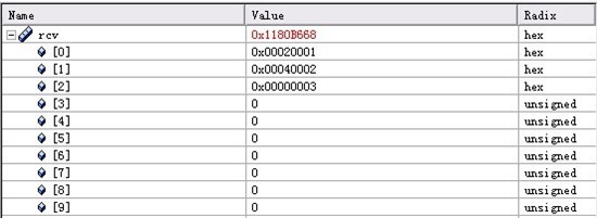

    After that, I'm very glad tosee the data begin to transfer from xmt to rcv. However, the data didn't transfer entirely. I set the ACNT=N=10.  From the Watch Window, I just see:
    and the xmt is as follows,
    As a result, the code is polling here all the time.
    while(!(edma3ccRegs->IPR & 0x0002));
    Can you give me any suggestion to this? And why the data didn't transfer entirely?
    Thank you very much!  O(∩_∩)O~
  • Hi,I know why the data didn't tranfer entirely. That's because I set ACNT=10.  That means I want to transfer 10 Bytes=2.5*Uint32. But  in fact I want to transfer 10*32bits , equals to 40*8bits,so when I set the ACNT=0x28. The transfer succeed.
