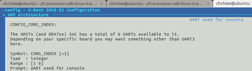

I'm using custom AM5748 board and got U-boot working on COM3.
Now I tried COM8. Pinmux is set accordingly.
In defconfig I see that COM ports are restricted to 1..6.
So I changed Kconfig to allow 1..8 and set the CONFIG_CONS_INDEX to 8

I did not work. Then I started the USB JAG debugger and found out that it hangs in ns_16550.c, line 173:
while (!(serial_in(&com_port->lsr) & UART_LSR_TEMT));

1) Should COM8 work at all with AM5748?
2) what is the correct way to change UART, using CONFIG_CONS_INDEX, or by modifying the device tree? I'm using .cfg based on tisdk_am57xx-evm-rt_defconfig, so "U-Boot config based on DT" is enabled.
3) why could it hang in the line stated?

  • Hello Chris,
    It is no longer needed CONFIG_CONS_INDEX to be changed in "kernel menuconfig" to change the console in AM57xx platform devices. You are probably missing the UART8 clock control sources. Please, refer to the attached patch in this post where I've changed the UART from 3 to 9 in AM572x GP EVM, and do the similar changes for your UART8.
    Kemal
