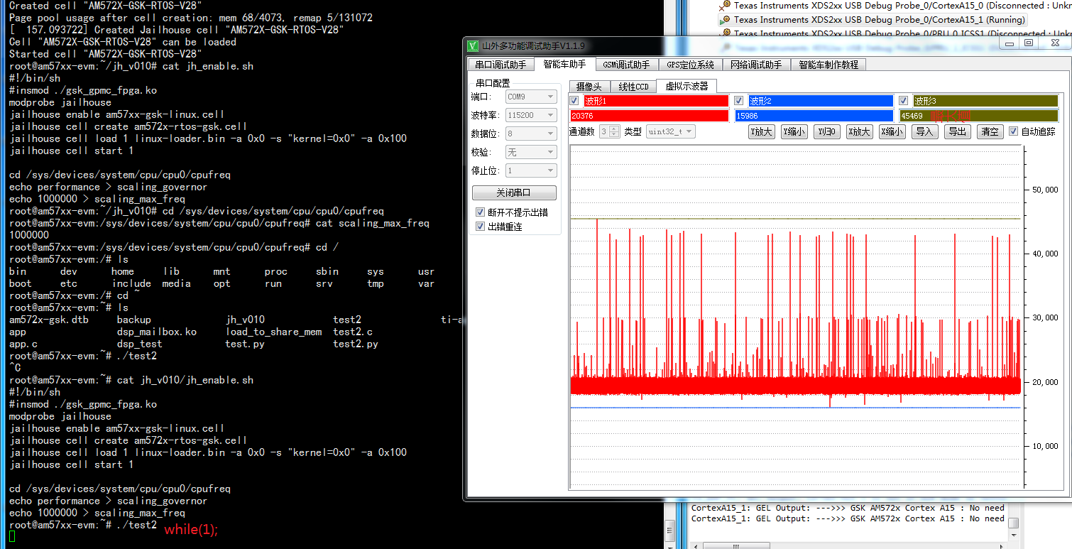

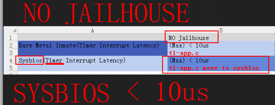

    I am using sysbios in the jailhouse to use timer to get the interrupt latency. The worst case is more than 2ms, which is an impossible delay.
  • The first step to debug the issue is to run your RTOS application w/o the Jailhouse. Just make the app as an RTOS application and run it via CCS.
    Prove that it works with desired latency as a standalone RTOS app.
  • Please look at my data carefully!!!!!!!!!!
    There is interrupt latency data for running RTOS application w/o the Jailhouse !!!
    Prove that it can run as a standalone RTOS application with a worst interrupt latency of 10us.
    But when I put it in the jailhouse, the worst case for interrupt latency is up to 2ms.

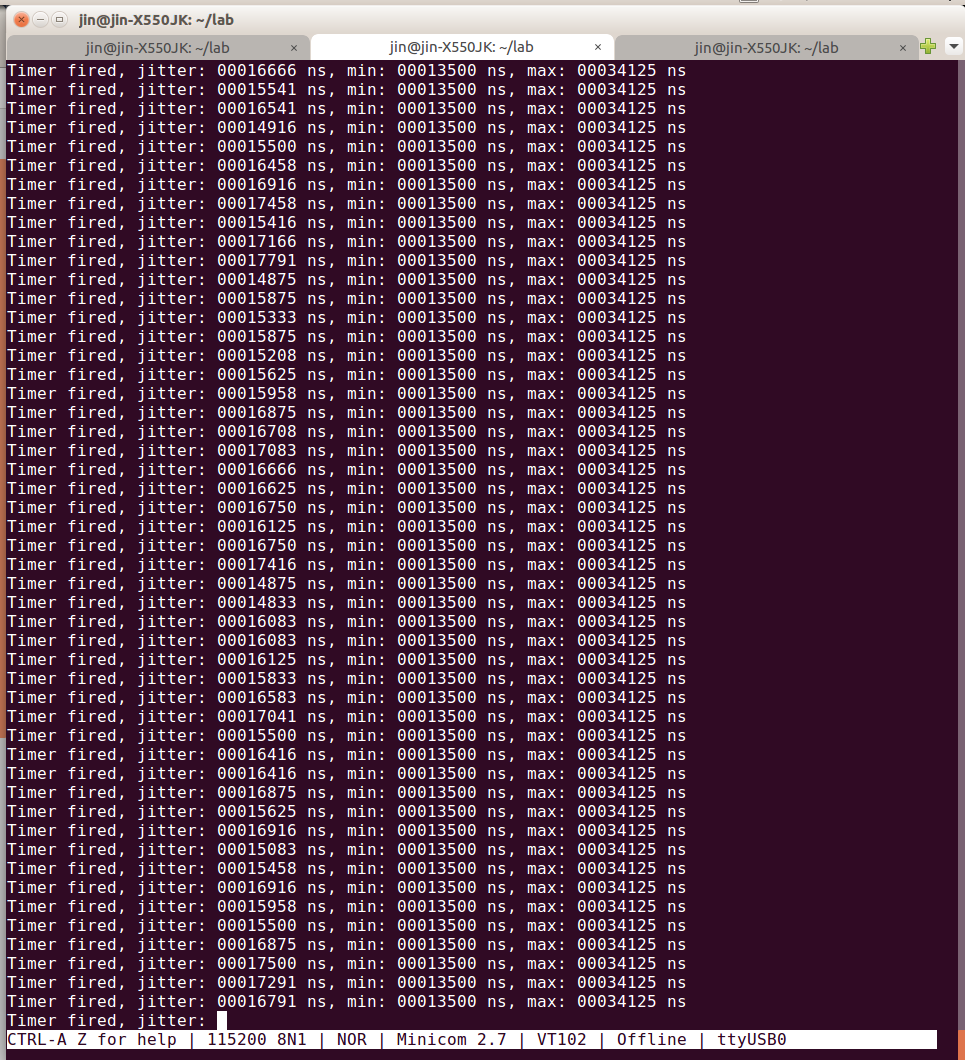

    After running for few minutes I see
    TEST1: JAILHOUSE TI-RTOS:
    jitter: 19969 ns, min: 18722 ns, max: 568618 ns
    jitter: 21409 ns, min: 18722 ns, max: 568618 ns
    jitter: 19500 ns, min: 18722 ns, max: 568618 ns
    jitter: 19202 ns, min: 18722 ns, max: 568618 ns
    jitter: 19118 ns, min: 18722 ns, max: 568618 ns
    TEST2: TI-RTOS (non-jailhouse)
    jitter: 14776 ns, min: 14124 ns, max: 40320 ns
    jitter: 14972 ns, min: 14124 ns, max: 40320 ns
    jitter: 14960 ns, min: 14124 ns, max: 40320 ns
    jitter: 14628 ns, min: 14124 ns, max: 40320 ns
    jitter: 14644 ns, min: 14124 ns, max: 40320 ns
    Then TEST1 max jiiter ~570us, TEST2 max jitter ~40us. Let me know if this agree with your results. Or if in order to get max jitter ~2ms in TEST1 I need to leave the test running longer.

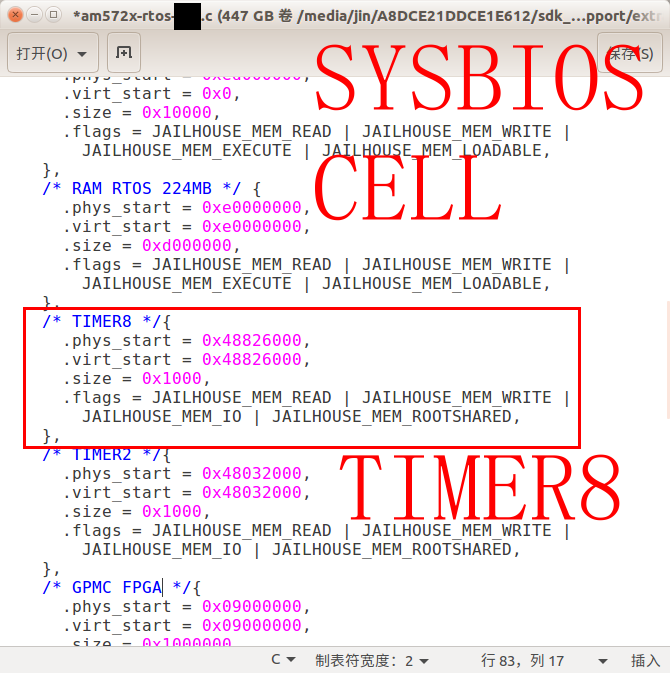

  • Hi,  after checking your code, I did few modifications which helped a little bit to reduce jitter. Summary list of changes below:
    • I think you had timer2 by mistake enabled in *.cfg. As a test, I built RTOS application using “TimerSupport.availMask = 0x0080;”.  It worked OK.
    • I compared your app.cfg  and the one from TI_RTOS_PSKD/../jailhouse/rtos/icss-emac . I merged differences that I considered applied, such as MMU settings, CacheEnable, and timer number. Attached new project for your reference.
    With changes, max jitter is ~500us, however, I only saw once the jitter close to 500us, most of the time is ~47us, and once in a while ~180us

    I am checking with our MMU experts if there is any additional optimization with can do for TIMER8 memory region. However, please keep in mind that getting same results as baremetal might not be possible, as SYSBIOS might some times runs other tasks in the background.
    idkAM5728_inmate_opt.zip
    thank you,
    Paula

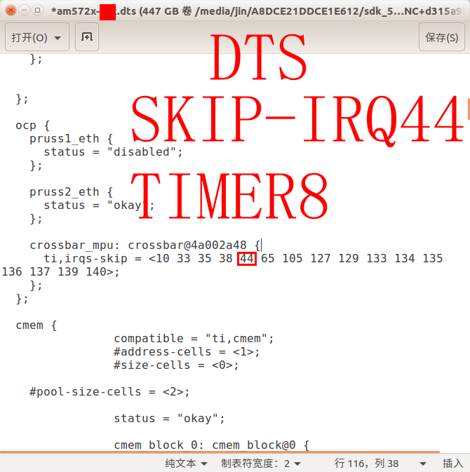

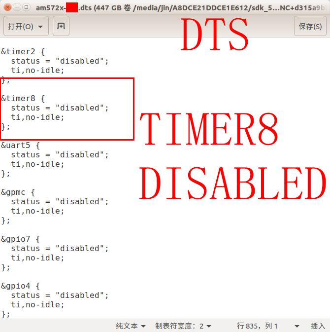

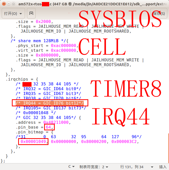

  • Yes, I have enable timer2 and timer8 on inmate.

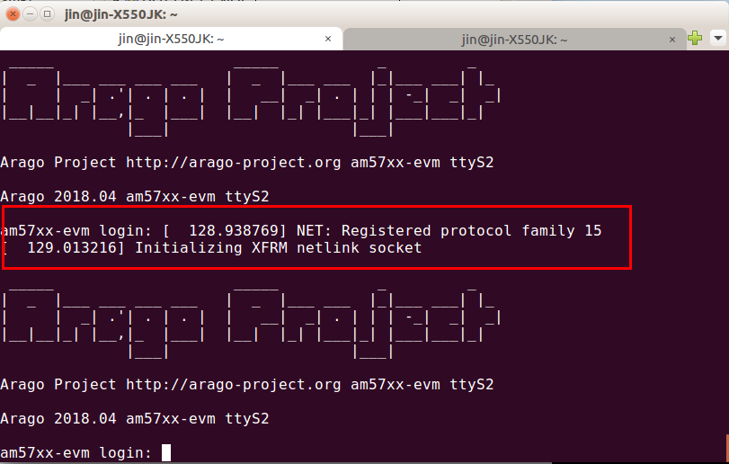

  • Hey,
    Early testing has such a phenomenon, I don't know if it can help your work:
    Jailhouse-sysbios interrupt latency test in custom board, when Linux printk "Net: Registered protocol family 15" and "Initializing XFRM netlink socket", get max int latency instantaneously.
    thank you.

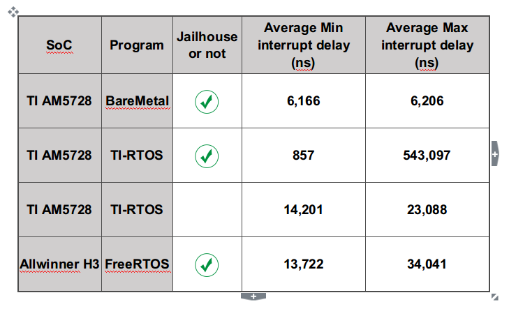

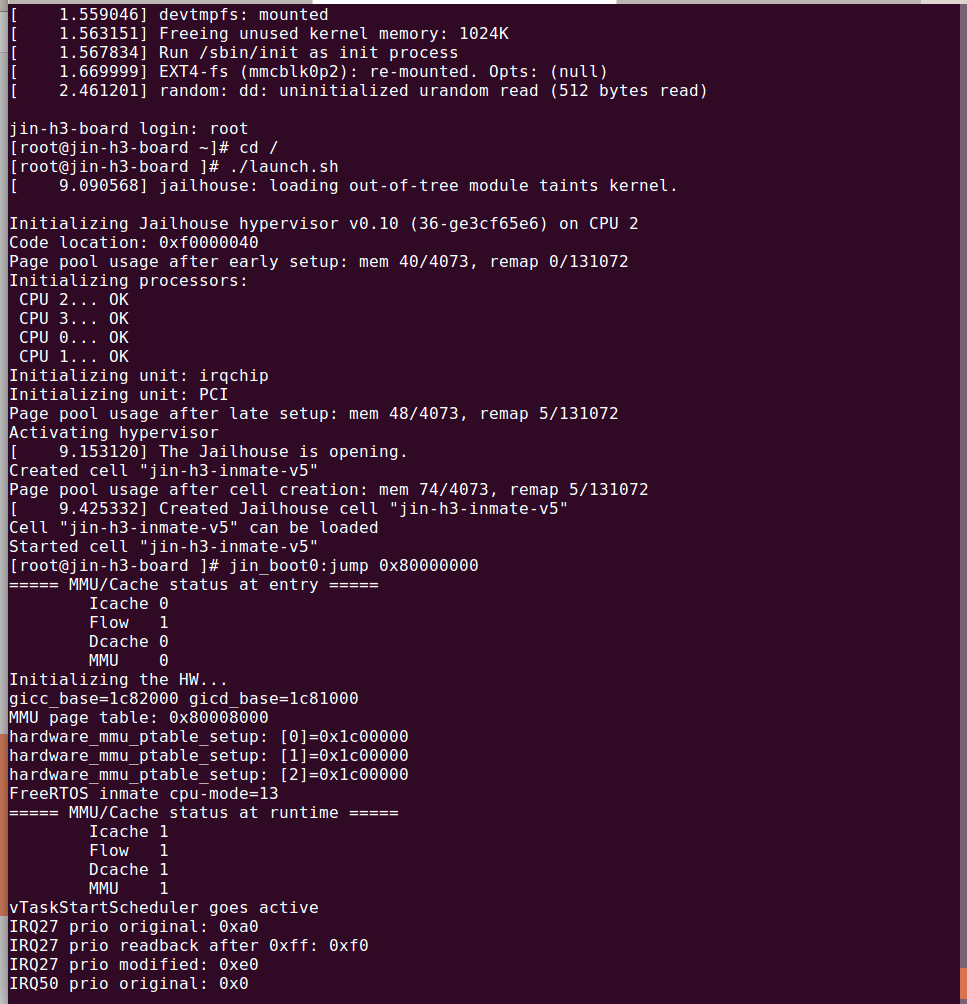

  • For comparison test, I ported the jailhouse to orange pi lite (Allwinner H3 CortexA7 4Core 1.08GHz).
    The inmate is running freertos to test interrupt latency.
    MMU is on.
    Test Results:

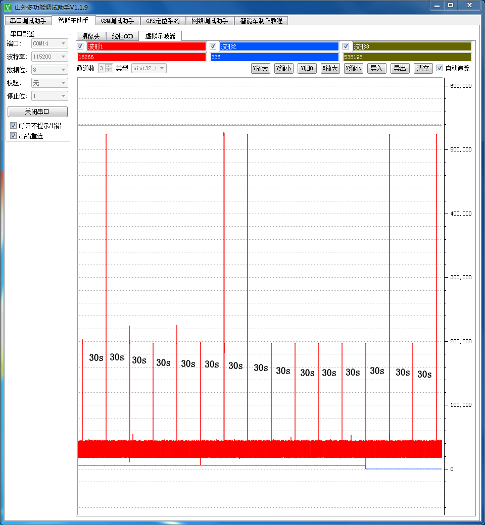

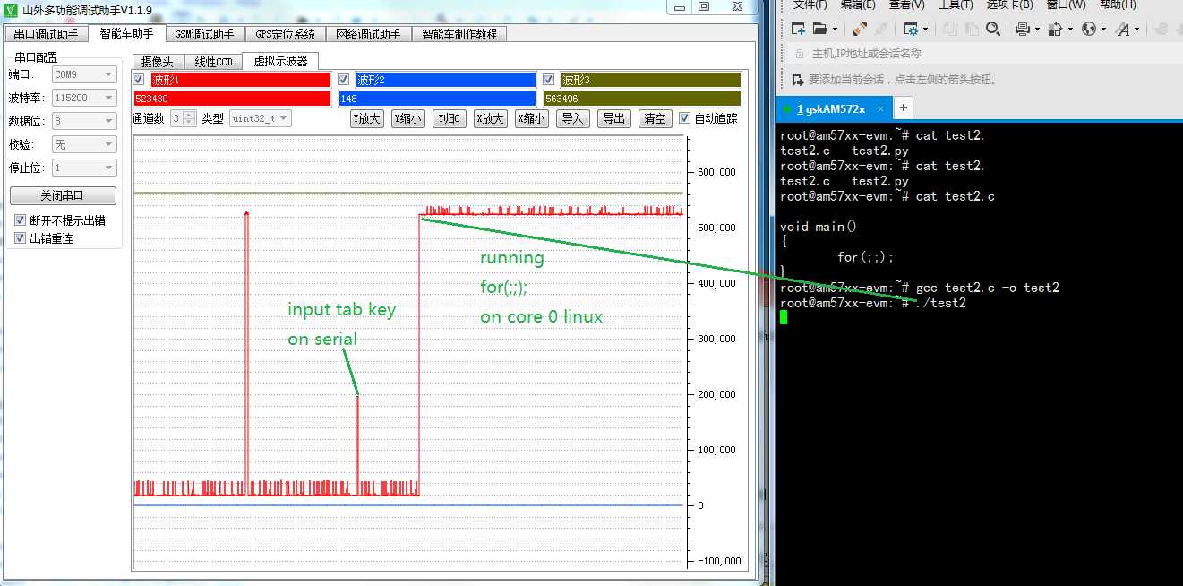

  • We observed the curve of the interrupt latency generated by sysbios running the timer in the jailhouse.
    The red curve is the current interrupt delay.
    We found that the larger interrupt latency is accurate for 30s.

    Now there is a new test phenomenon.
    When sysbios is used as the inmate test interrupt delay for jailhouse, core0 enters the tab button via serial or runs for(;;);, which causes a large interrupt latency.
