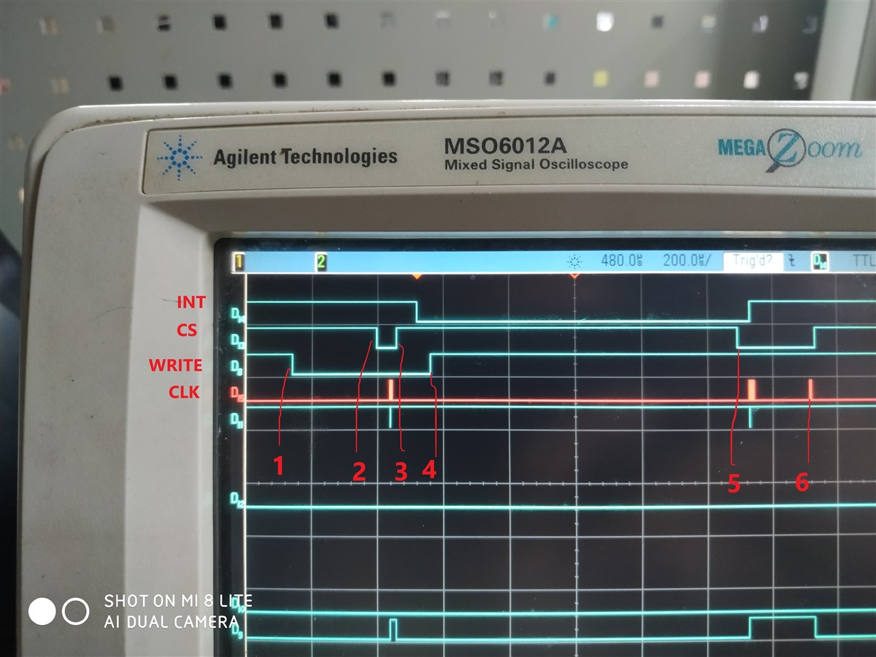

I am using ti-processor-sdk-linux-rt-am335x-evm-05.00.00.15 on an 800MHz AM3354, for a custom board. On my board, I connect the AM3354 to a STM32 MCU via SPI bus. AM3354 acts as the master. There is no other SPI devices on the SPI master. When the MCU need to send data to AM3354, it triggers an interrupt.
On the AM3354 side, I use an interrupt thread to access the SPI bus synchronuously. As the first several read-in data contains the length of the total packet, I split the read MCU procedure to two part, first read-in the part contains the length, then read the total packet according to the length.
The problem is the access of SPI is too slow. I have tried to increase the irq thread, spi0 thread and the application thread priority to SCHED_FIFO, 99. Please see the following picture:
1. From the picture, you can see first the WRITE signal goes low. It is corresponding to the source line gpio_set_value(p_drvdata->boot0, 0) in function ruifu_mcu_controller_write;
2. then the CS is activated, but the delay is also huge, over 200us.
3. Then after the actual write, CS goes high. MCU handles the command and drive the INT low very quickly. But at this time, the system call write(kernel space ruifu_mcu_controller_write) didn't finish yet.
4. After about 100us, the WRITE line goes high, it corresponding to the line gpio_set_value(p_drvdata->boot0, 1) in ruifu_mcu_controller_write. At this point, the user space application finished the command sending to MCU. But obviously, MCU already finished handling the command and is waiting for the following SPI read.
5. After about 900us, AM3354 begin to read the MCU response in the irq thread. It start to read the first part, which contains the length info of the total packet.
6. After another 200us, the remaining part of the total packet are read out.

My questions are:
1. The delay from step 1 to 2 is too large. Is there any way to reduce it?
2. The delay from 3 to 4 seems so large. Is there any way to reduce it?
3. It seems the interrupt is not serviced in time. The delay from 4 to 5 seems so large. This is the most severe problem I think.
4. How could I improve the two consecutive SPI message transfer? It is the delay from step 5 to 6, corresponding to the two call to ruifu_mcu_controller_sync in ruifu_mcu_controller_irq
I didn't start any other user APP, and from the command top output. The system is not busy.
I found someone use PRU to do the SPI transfer, like github.com/.../wiki. Is that applicable to AM3354? And is there some easier way to improve my case? I feel the PRU method overkill for my case.
  • Thanks for your post. A few clarifying questions:
    1. Where do your timing expectations come from? Is the scenario above typical, or worst case?
    2. Could you please post/attach your DTS file, specifically your SPI DT nodes?
    I'm sorry, but I can't review the code specifically. I'll be happy to take a look at the DT config and see if I can make any suggestions.
    The AM3354 does not have PRU cores. However, if you chose to move to a device with PRU cores, the PRU would be the absolute lowest latency way to manage SPI communication and should be very similar to other MCUs.
    I hope this is helpful.
  • For your question:
    1. This is the typical scenario. I managed to capture the timing sequence several time, they are quite similar. I don't know the typical SPI timing about the Linux Rt running on AM335x. Do you think the sequence are normal?
    2. My dts files are attached. I saw in a post that removing DMA names will improve the SPI timing. So I removed those DMA names in SPI node, as my SPI packet will not be large enough to trigger a DMA.

    Can you see any abnormal matters from the above result?
    BR
    /Li

  • I suggest you write a kernel driver for this communication.
    You can not handle this fast timing in user space.

  • I would like to revisit the proper sequence of the SPI protocol to begin communication,
    1) the bus master configures the clock (CLK)
    2) The master then selects the slave device with a logic level 0 (CS)
    3) The master sends a bit on the MOSI line and the slave reads it, while the slave sends a bit on the MISO
    Based on your diagram the communication protocol is out of sequence.
    You may need to need to add mutex or semaphores to maintain sequence between slave interrupt and setup to transmit the data.
  • The sequence is correct. I can visit the slave and got the response as expected. The problem here is the about the slow SPI access in a irq thread. As you can see in my code above, there is already a mutex in my irq thread:

  • Hi, I only want to speed up the SPI access.
    In the file, spi-omap2-mcspi.c (located under "<linux-xxxx>/drivers/spi"), modify the value of the variable "DMA_MIN_BYTES" to 4 and please let me know if it helps with your SPI access.

    I have written code to access the SPI register directly, instead of use the standard spi_transfer. It improves a lot. But I still feel there are something abnormal. I will try your method later and let you know the result. You can close the issue now.
    Thanks.
