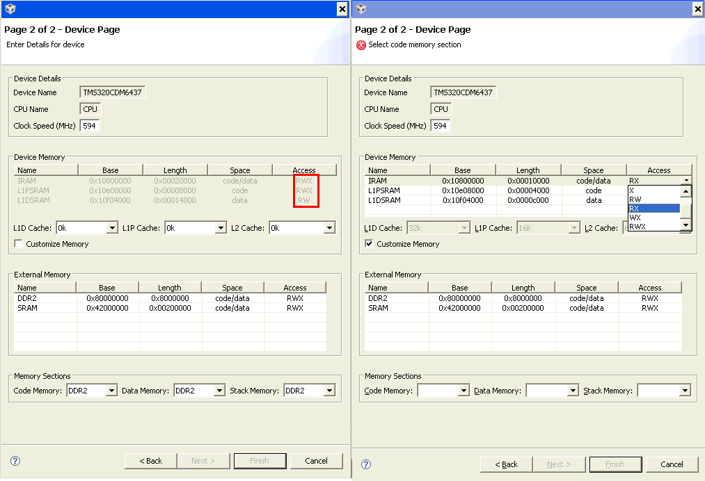

Hi All,
I was reading a post relating C64x+ memory protection:
Brad Griffis said:
Sorry, but these features are not supported on the DM6437. This is documented in the DM643x DSP Subsystem Guide.
Section 2.3.1:
The DM643x DMP does not support the L1P memory protection feature of the standard
C64x+ Megamodule.
Section 2.3.2:
The DM643x DMP does not support the L1D memory protection features of the standard
C64x+ Megamodule.
Section 2.3.3:
The DM643x DMP does not support the L2 memory protection feature of the standard
C64x+ Megamodule.
But why in configuring the RTSC platform I was still able to edit their access properties?
They are intially gray, what does that gray mean?
Sincerely,
Zheng
