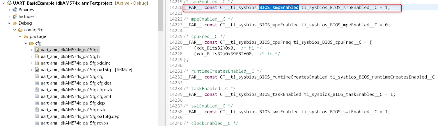

When used the "USB_DevBulk_idkAM574x_armExampleProject" and modified the code to enabled the SMP mode, but customer met the following error. It showed the following error.
This module does not support SMP mode. Please use ti.sysbios.family.arm.a15.smp.Cache module instead.
Would you please provide the solution to resolve this issue?

    They have used the v5.0.0 PSDK and added the smpEnabled=true to cfg file on sample code.

    We also found the same error with PROCESSOR-SDK-RTOS-AM57X 05_01_00_11 like below;
    - C:\ti\pdk_am57xx_1_0_12\packages\MyExampleProjects\USB_DevBulk_idkAM574x_armExampleProject
    - CCS 8.1.0.00011
    We would like to share the pdf in detail and the build log.
    We would appreciate if you check the behavior.

  • Kaka,
    Can you try using the ti.sysbios.family.arm.a15.smp.Cache module instead of the ti.sysbios.family.arm.a15.Cache module in the .cfg? I would edit the file as a text file instead of via XGConf.
    Todd

    We tried using the ti.sysbios.family.arm.a15.smp.Cache module instead of the ti.sysbios.family.arm.a15.Cache module in the .cfg which you guided.
    But we found the other Errors like below.

  • It looks like the CacheP module in the PDK was written to be used with the non-SMP Cache module. In the CacheP_tirtos.c file, I see the following
    #if defined (SOC_AM335x)
    #include <ti/sysbios/family/arm/a8/Cache.h>
    #elif defined (SOC_AM437x)
    #include <ti/sysbios/family/arm/a9/Cache.h>
    #elif defined (__ARM_ARCH_7A__)
    #include <ti/sysbios/family/arm/a15/Cache.h>
    So it is explicitly using the non-SMP APIs. Since you are include the SMP version in the .cfg (and not the non-SMP ones), you are getting unresolved symbols.
    Someone on the PDK team needs to look at this and determine the best plan to move forward with this. I've moved this thread to them.

    The Processor SDK RTOS driver example was not tested for SMP mode. You can refer to the e2e.ti.com/.../758370 for the same issue when converting a non-SMP project into SMP.
    The TI RTOS OSAL library was pre-built with #include <ti/sysbios/family/arm/a15/Cache.h>. It is not intended for SMP support. For SMP purpose, #include <ti/sysbios/family/arm/a15/smp/Cache.h> should be used and rebuild the OSAL library. Please try this and if it worked.

    It seems to be success to build.

    Yes, if your application includes the file BIOS.h then there is a flag "BIOS_smpEnabled" defined  which during RTOS compilation picks up the boolean value defined from the .cfg setting of BIOS.smpEnabled from the configuration file.
    TI RTOS XDC build auto generates a file <projectName>_pa15fg.c in the folder DEbug/configPkg/package/cfg folder that gets compiled in application. This file defines the value as a FAR const that gets picked up by the #define BIOS_enabled when you include BIOS.h file (located at ti/sysbios/BIOS.h in bios package)
    For example check my UART Example code where SMP is enabled:
    Hope this helps. Let us know if there are any other questions.
    Rahul
