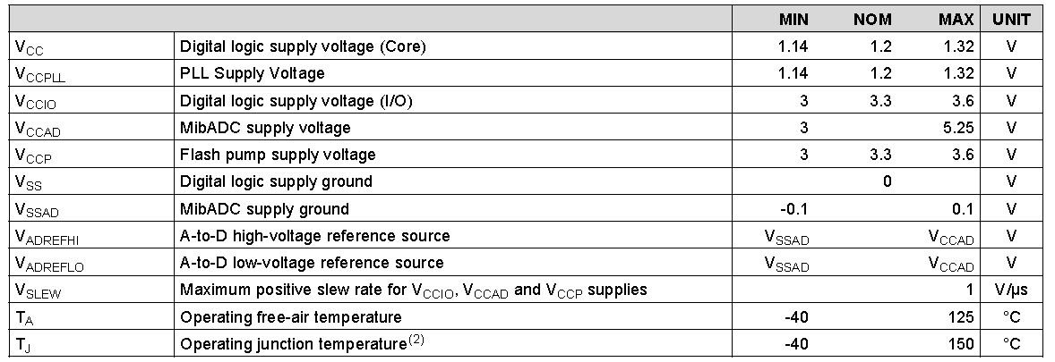

The internal input voltage of the TMS5701227CPGEQQ1 is 6.2V, and the supply voltage of the MCU is 3.3V. Is there any protection circuit such as input current limiting resistor inside the MCU and AD?
