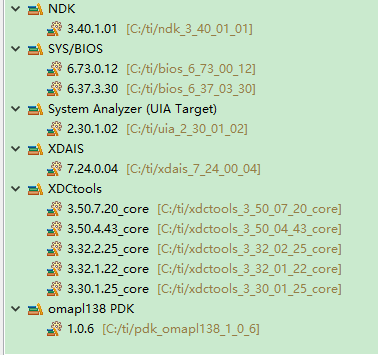

Step1. I have installed the CCS  and PDK_OMAPL138 and other components in the default path "C:\ti".As being shown below.

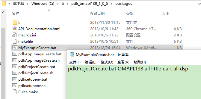

Step2. I create the file "MyExampleCreate.bat" in the pdk packages directory. And  write "pdkProjectCreate.bat OMAPL138 all little uart all dsp" to the file.
Step3.I ran the file MyExampleCreate.bat, in the Command line window. The result is shown below.
While Copying macros.ini file, an error has occurred, as"The system cannot find the specified path".

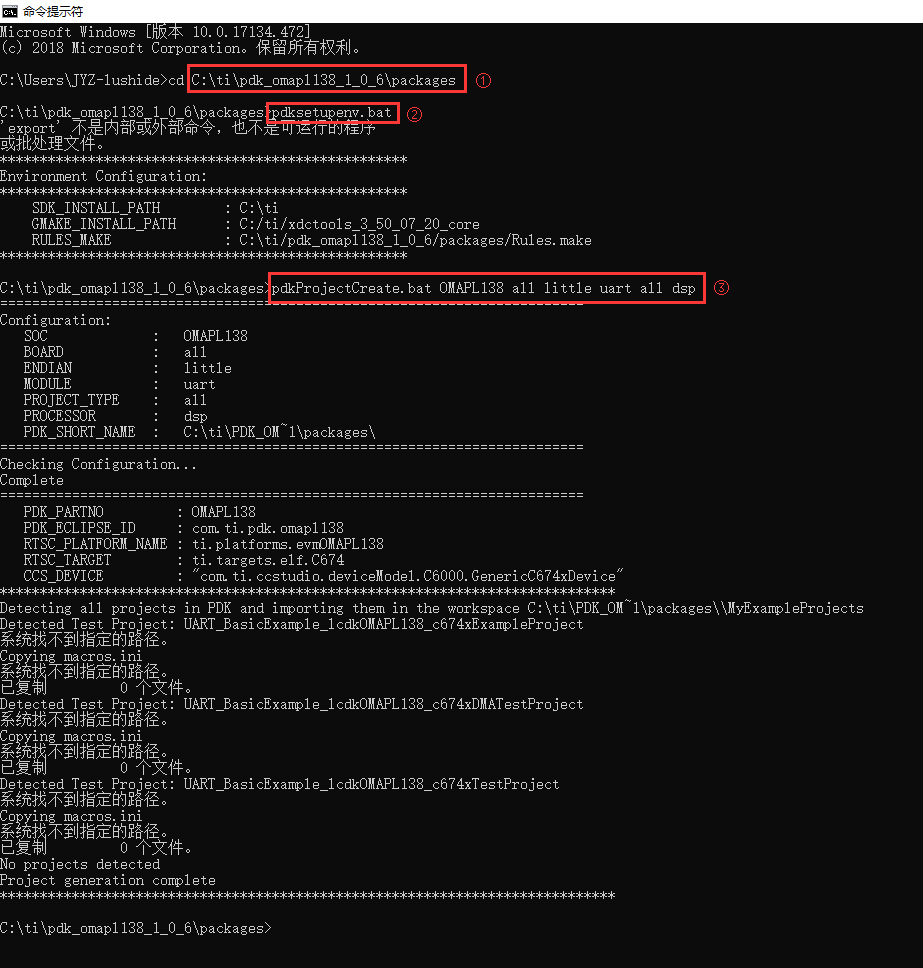

  • Hi,David,
    Thanks for your reply.
    Now, I run the pdksetupenv.bat, an Error occured as "'export' is not an internal or external command, nor is it a runnable program or batch file".
    I want to know what the pdksetupenv.bat file does. Set environment variables?
    I set the three environment variables in the image above manually.And then run the MyExampleCreate.bat file.The result is still the same,cannot find the path.

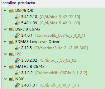

    Please make sure you have discovered and installed the SDK in CCS as shown below:

  • Hi,Sahin,
    Thank you very much for your reply.
    I'm sure I have  installed the SDK in CCS.
    I close the CCS, and then run the following commands in a terminal window:
    > cd C:\ti\pdk_omapl138_1_0_6\packages
    > pdksetupenv.bat
    And the result shown as below:
    The OS on my PC is Windows 10 (64bit).Is that matter?

  • Hi Shide,
    I would recommend having only one instance of XDCtools and SYS/BIOS installed in CCS at a time. And the SDK has been validated on Windows 10, so that shouldn't be the problem.
    Looking at your command log, there is nothing that sticks out to me that could be causing this issue. The easiest solution might be to do a clean re-install of the SDK, if that is an option for you.

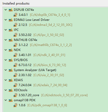

  • Hi,Sahin,
    Thank you very much.
    I have  Re-installed the CCS.And now  having only one instance of XDCtools and SYS/BIOS installed in CCS.
