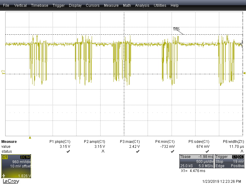

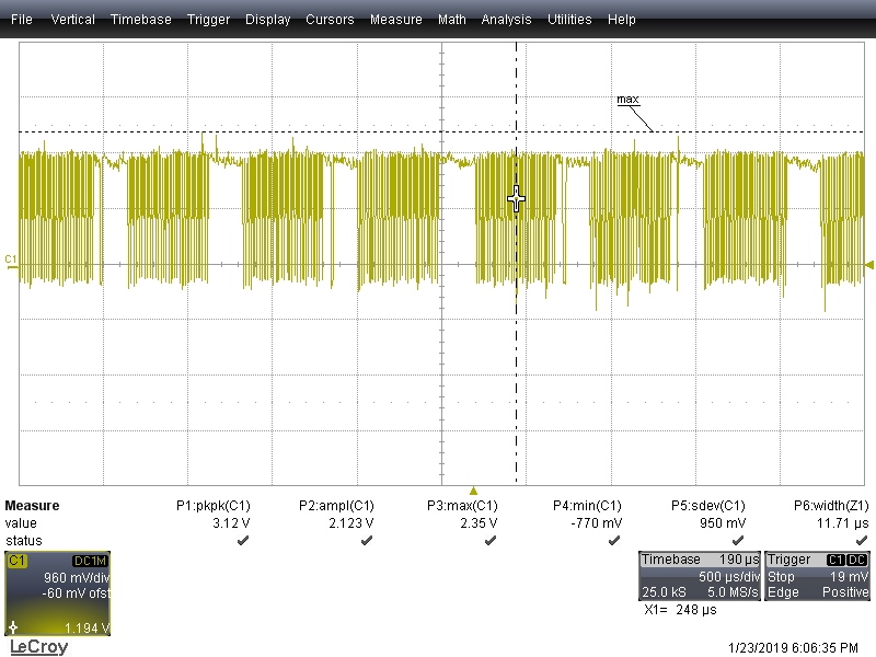

    If you scope the NAND signals, you can tell the software overhead apart from the GPMC timings in each phase by looking at CS low period and comparing it to the CS high period (or period of the REn signal during a read).
    You might also be able to profile the code to identify the slowest routines.

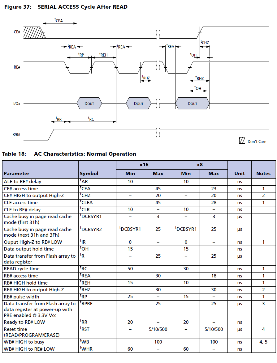

    Running some quick numbers...
    FCLK # 100MHz = 10ns per cycle
    Each GPMC register bit field specifies a number of FCLK cycles for an event to occur (ie CS low or CS high)
    Take the command latch cycle for example...
    NAND datasheet specifies timing requirements...
    - tCS: setup time CS low before WE high
    - tCH: hold time CS low after WE high
    - tWP: WE low before WE high
    - tALS: setup time ALE low before WE high
    - tALH: hold time ALE low after WE high
    So ideal WRCYCLETIME can be calculated in ns as max((tCS + tCH), (tALS+tALH), (tWP+max(tCH,tALH)))
    And ideal WEOFFTIME (in ns) can be calculated as tWP
    To get values for the register bit fields, divide by the FCLK period (10ns) and make all the events relative to StartCycleTime, where CS first goes low starting the cycle.
    You then need to add margins to these timings to account for the switching characteristics of the GPMC peripheral in silicon. There will be slight timing variations between devices.
    The datasheet provides switching characteristics of these signals in two ways:
    1) From internal GPMC_FCLK cycle to a signal transition on the pins (Table 7-26, ex. Delay time, output chip select gpmc_csn[x] generation from internal functional clock GPMC_FCLK)
    2) From one signal transition to the next at the pins (Table 7-28, ex. Delay time, output chip select gpmc_csn[x](13) valid to output write enable gpmc_wen valid).
    In general, adding margin of one FCLK cycle should be sufficient.
    So for the MT29F4G08 datasheet that I found...
    tCS = 35ns
    tCH = 10ns
    tWP = 25ns
    tALS = 25ns
    tALH = 10ns
    So we need a CS low period of at least 45ns (5 FCLK cycles will give us ~50ns)
    tWP and tALS are smaller than tCS, so we'll satisfy their setup time requirements of 25ns if we set WE low at the beginning of the cycle with CSn.
    CSONTIME = 0
    WEONTIME = 0
    ADVONTIME = 0
    WEOFFTIME = 4 (4 FCLK cycles give about 40ns > 35ns - datasheet table may force us to add more margin)
    WRCYCLETIME = 6 (only need 10ns of hold time, but would have no or negative margin - give 20ns for margin)
    CSWROFFTIME = 6
    ADVWROFFTIME = 6
    That leaves us with a CS low period of about 60ns, which is greater than the 45ns min.
    Follow this procedure for address latch, write data, and read data cycles.
    You will end up using the same register settings for all cycles, so if one forces you to use slower timings, then it drives the timings for all cycles.
    For a read cycle, consider also the propagation delay to and from the NAND memory and the output delay of the NAND device so you give enough margin for the ReadAccessTime.
    When you populate the GPMC timings into the DTS, it uses nanoseconds instead of GPMC FCLK cycles. So the DTS you have attached actually looks pretty fair.
    There may be other things slowing down the access like non-posted writes (waiting for confirmation from the NAND), or using the WAIT signals to stall the bus.
    The TRM has lots of details. Check out 7.1.2.3.12 NAND Access Description, specifically 7.1.2.3.12.2 NAND Device-Ready Pin.
    Did this exercise help you to understand the process of optimizing the GPMC timings?
    There will likely be some trial and error involved also.

    From your Input i did the calculation of gpmc parameters using nand MT29F4G08ABBFA
    CSONTIME = 0
    CSWROFFTIME = WRCYCLETIME
    WEONTIME = 0
    ADVONTIME = 0
    ADVWROFFTIME = WRCYCLETIME
    CSRDOFFTIME = RDCYCLETIME
    OEONTIME = 0
    for the MT29F4G08ABBFA datasheet that I found...
    tCS = 25ns
    tCH = 5ns
    tWP = 15ns
    tALS = 10ns
    tALH = 5ns
    So we have CS low period is 30ns (3 FCLK cycles will give us 30ns)
    WRCYCLETIME can be calculated in ns as max((tCS + tCH), (tALS+tALH), (tWP+max(tCH,tALH))) is 30ns
    And ideal WEOFFTIME (in ns) can be calculated as tWP is 15ns
    CSONTIME = 0
    WEONTIME = 0
    ADVONTIME = 0
    WEOFFTIME = 2 (2 FCLK cycles give about  tWP -> 15ns)
    WRCYCLETIME = 4 (10ns of hold time)
    CSWROFFTIME = 4
    ADVWROFFTIME = 4
    Here CS low period is about 40ns, which is greater than the 30ns min.
    And For ReadAccessTime
    #define OEONTIME_NAND 0x0 /* RE# on time */
    #define OEOFFTIME_NAND 0x4 /* RE# off time */ /* AccessTime + 1Cycle = round max(tCE) + 1 Cycle = 30 ns + 1 Cycle = 3 + 1 = 4 */ /* Calculated from TRM Table 7-43 */
    #define RDACCESSTIME_NAND 0x4 /* sampling point for read */
    #define RDCYCLETIME_NAND 0x5 /* complete read time */
    #define CSRDOFFTIME_NAND RDCYCLETIME_NAND /* CE# off for read */
    #define ADVRDOFFTIME 0 /* this Value not clear for me from the TRM Table 7-43.*/
    From gpmc parameters i got these gpmc configs
    gpmc regs config1:     801
    gpmc regs config2:   40500
    gpmc regs config3:   40100
    gpmc regs config4: 2000280
    gpmc regs config5: 1040405
    gpmc regs config6: 4000081
    gpmc regs config7:     C44
    By using above values in u-boot patch
    with this u-boot NAND Reads 4 MB/s and 1 page (4096 Bytes) read  is 4 KB / mile Seconds.

  • From OScilloscope we capured the NAND page read time ~400 Micro seconds
    and delay between the page read is varying ~600 - 800 Micro seconds.
    When ubifs read from u-boot, we got above waveform.
    and u-boot raw nand read waveform is below one. here page read time is ~400 Micro Seconds, but delay is less compared to ubifs read from u-boot
    In both case page read time is ~400 Micro second. but ap per NAND Data sheet 155 Micro seconds
    delay between page read tRCBSY is 25 Micro seconds. but in raw nand read delay between pages is goes ~250 Micro seconds
    Here, i dont know how proceed further. help me to do further.

  • Give a calculation is know about GPMC parameters RDACCESSTIME and WEOFFTIME
    In TRM I read enough i guess, but i couldn't connect with date sheet values.
    WEOFFTIME needs to satisfy tWP from the device datasheet for command, address, and write cycles. WE can be low at the start of the cycle (when CS goes low). The datasheet has tWP = 25ns, so I actually think WEOFFTIME = 3 (30ns) would have achieved this with margin.
    RDACCESSTIME is the FCLK rise edge corresponding to when the GPMC latches the read data. It needs to give enough time for the read access time to occur.
    But the read cycle occurs after a command and multiple address cycles, so the start of the read access cycle is when the CS goes low after second page read cycle command is given.
    RDACCESSTIME = tCEA = 45 (so 50)
    Work backwards from there so you know when to drive low the nRE signal.
    tREA = 30ns (nRE must be low 30ns before RDACCESSTIME)
    nRE is controlled by OEONTIME and OEOFFTIME.
    RDACCESSTIME = 5 should work
    OEONTIME = 1 or 2
    OEOFFTIME = 6 (satisfies nRE low pulse: tRP = 25, so 30)
    In the case of this serial access, multiple reads are performed each read cycle. You can configure READMULTIPLE, ATTACHEDDEVICEPAGELENGTH, and PAGEBURSTACCESSTIME parameters to get an asynchronous page read to occur.
    Mark
