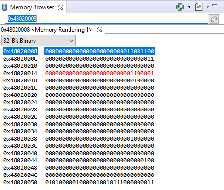

Hello.
Im working with idk AM5728. I want to use UART.3 to receive data. It worked successfully without interrupt. I tried to configure the RHR interrupt. I have used the main code in pdk_am57xx_1_0_11\packages\ti\csl\example\uart\uart_intr for enabling interrupt (I changed the parameters and addresses due to AM5728/IPU1/C0) and interrupt.h in pdk_am57xx_1_0_11\packages\ti\csl\arch\m4 for the interrupt functions.  but nothing happened.
I checked the registers through Memory browser. it seems that an interrupt is pending. The value in UART_IIR (0x4802 0008) shows that Rx_time out is pending. These are the values of my memory after receiving data.
Now i have some questions.
1. Some registers in datasheet have same addresses (like UART_IIR and UART_EFR). How is it possible, and how can i understand what register im checking in memory browser in CCS?
2. what is the difference of RHR interrupt and Rx time-out interrupt and when does Rx time-out interrupt happen?
3. Is it necessary to config interrupt priorities (because there is just one interrupt)? I didn't do anything in my code for this part and the function of  Intc_IntPrioritySet is empty.
4. The IPU can handle 80 interrupts Due to chapter 17 of datasheet (Interrupt controller): 16 internal and 64 external interrupts. How can I set the ISR for each of them.
5. What should i do to config NVIC in IPU?
5. Can I use CMSIS library for my purpose? If i can, how?
6. Is there any bare metal example for UART (with interrupt) or for using NVIC?
Here is my whole project. Could you please take a look at my code?
uart_interrupt_m4_BareMetal.rar
Any help regarding this issue would be greatly appreciated. Thank you

  • ali,
    1. Register access depends on the register access mode, although register access modes are not correlated to functional mode selection. Three different modes are available:
    • Operational mode
    • Configuration mode A
    • Configuration mode B
    see TRM 24.3.4.7.1 Register Access Modes
    2. RHR interrupt source - DRDY (data ready) (FIFO disabled), RX FIFO above trigger level (FIFO enabled)
    Rx Time-out interrupt source - stale data in Rx FIFO, refer to e2e.ti.com/.../44142
    3. Not necessary.
    4. You can configure the mapping of device interrupts to IRQ_CROSSBAR inputs using CSL_xbarIrqConfigure() API.
    5. Refer to UartINTCConfigure() in uart_intr\main.c
    5. not recommended.
    6. The closest example is the one you referred to: ti\csl\example\uart\uart_intr

  • thanks a lot. I have another question. Where is the specific address that isr function should be written?
  • ali,
    You don't need to specify the isr function address. Please refer to link_m4.cmd in PDK packages\ti\csl\example for memory allocation.
    The isr function is registered through Intc_IntRegister()
    /* Registering the Interrupt Service Routine(ISR). */
    Intc_IntRegister(UART_INT_ID, (IntrFuncPtr) UARTIsr, NULL);
    You can look into the Intc_IntRegister() in pdk packages\ti\csl\arch\m4\src\interrupt.c for vector table and isr address details.
    Garrett
  • I solved the problem myself. I found a problem in the code that you referred. I used this header file for AM5728. It generates an address for VTOR(Vector Table Offset Register) that has value in its 7 lower bits, but accessing to these bits are not possible(They are always Zero ). when I changed the address The problem solved. Any way thanks for your help.
