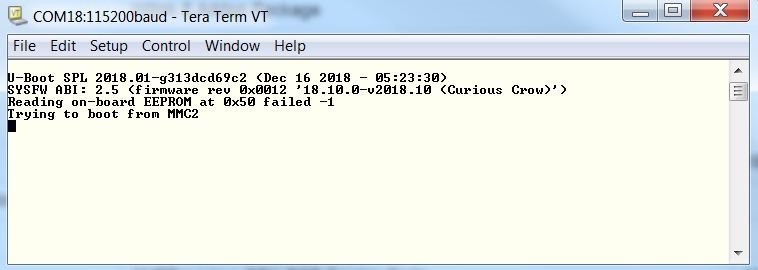

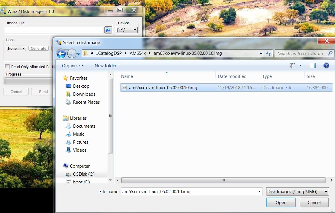

I made a SD card with am57xx-evm-linux-05.02.00.10.img.zip, it can boot on IDK board(REV:1.0), can't boot on EVM board (REV:E2), console message as below:
Both boards have the EEPROM U56 on board, both left R328, R330, R329 DN, so the address should be same of 0x50.
Was the EVM REV:E2 did not flash Board ID in factory?
Please advise how to make the REV:E2 board work with Processor SDK 5.02.
