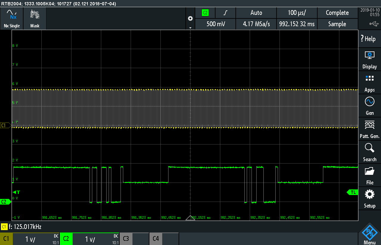

    Thank you for the suggestion! (yes I isolated the problem using fixed phy by changing the dts file on emac.) However after further debugging, I'm convinced that our issue is different than the reset issue. Although our RESET_N is only controlled by POR but not by a GPIO, I think the POR should be sufficient. During kernel boot, when I probed the MDC and MDIO lines, there were activities.
    Ch1 is MDC and Ch2 is MDIO. My questions:
    (1) Why the MDC = 125K? On kernel log it says bus freq 1M. Did I miss anything in the dts file?
    [    3.191524] davinci_mdio 48485000.mdio: davinci mdio revision 1.6, bus freq 1000000
    (2) The MDIO line looks like a voltage level not going to ground, is this a hw problem? Perhaps this is the reason the mdio probe failed?
    Thanks again!
    Jan
  • Hi Jan,
    Sorry to hear the e2e post didn't fix the issue. Thanks for posting the scope capture that will help with discussions. Your HW suggestion as the root cause might be correct, I need to involve another team here for additional assistance.
    Schuyler

    A mid level voltage from the DP83867 is characteristic of improper strapping on GPIO_0.  If GPIO_0 is placed into mode 2 or mode 4, MDIO will become unresponsive and pull to mid rail.
    If you have this GPIO connected to your processor, the processor may drive a voltage, or have an internal pull resistor that is causing this improper strapping.
    Please try isolating GPIO_0, or pulling it down strongly to ground to go into mode 1.

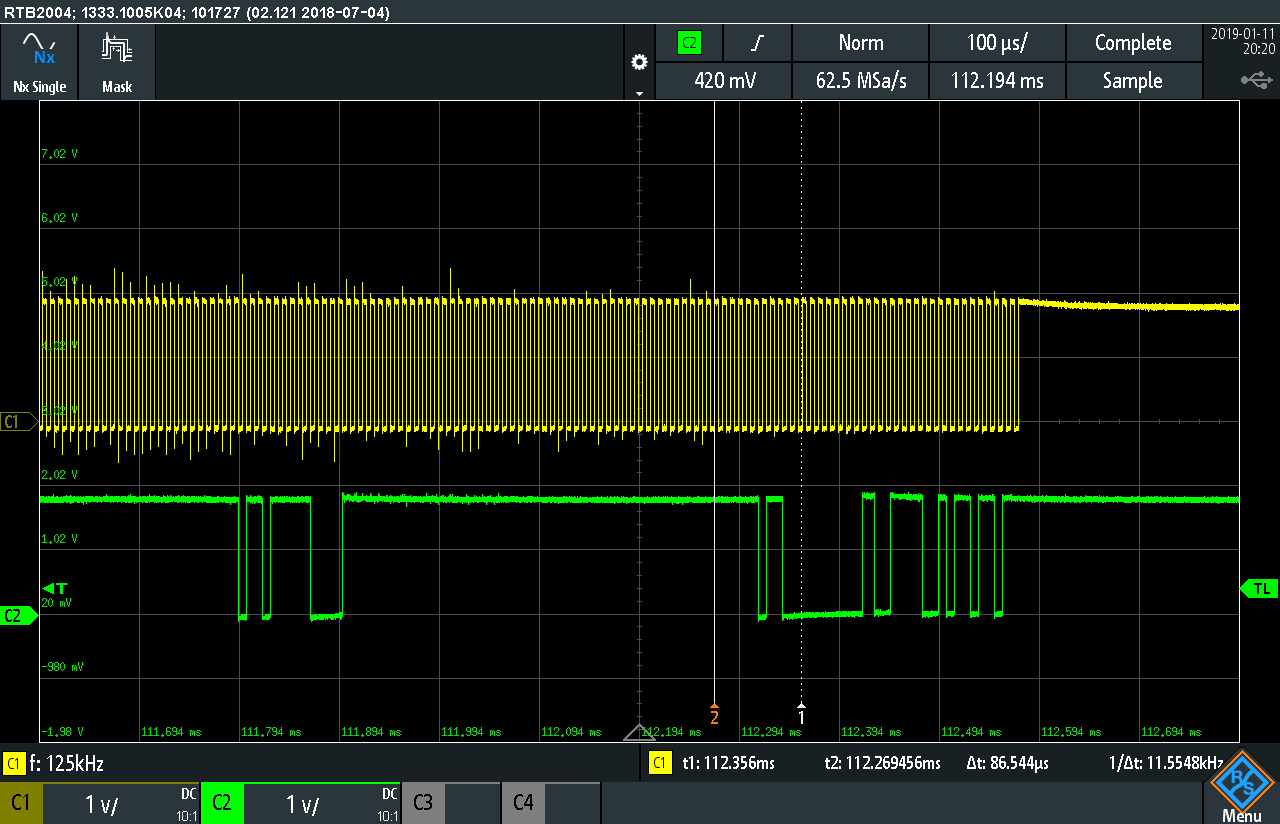

  • Thank you Bob for the suggestion!
    After double checking the schematic, we realized that MDIO line was pulled up only to 1V rather than the I/O supply 1.8V. Now we fixed the pull up to 1.8V and the MDIO signal looks much better. However the eth0 init still fails.
    [   10.302100] net eth0: initializing cpsw version 1.15 (0)
    [   10.353590] net eth0: phy "/ocp/ethernet@48484000/mdio@48485000/ethernet-phy@0" not found on slave 0
    The GPIO_0 is connected to the gate of a mosfet to drive an LED. We probed it and it was at 0 at RESET. I see MDIO read response on scope, but not sure why the init still fails. Could I be missing something in the software configuration or device tree?
  • Hi Jan,
    If you are seeing clean MDIO responses, then I believe it is a SW configuration issue. I will return this thread to our Linux experts.
