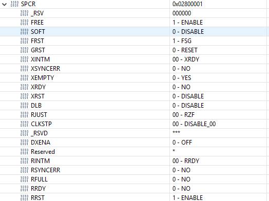

    Can you please provide a register dump of the SPCR?
    Also, please ensure you are setting RRST bit to 1, followed by the FRST bit.
  • Hi Sachin,
    Thanks for the reply. I'm Using the Quick start OMAPL138 example and customized to enable McBSP functionality via Mux. Yes the software uses edma to service mcbsp.
    Yes, McBSP registers are configured and while starting the McBSP enabled the RRST bit.
    Please find SPCR register screenshot in the attachment.

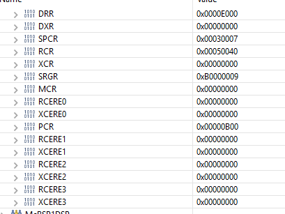

  • Hi Sahin,
    Thanks for the response. Configured McBSP0 to receive the data from other processor (Verified in scope that other processor transmits FSR, CLK, Data) but It appears that the software doesn't receive the complete data (partial or incomplete data in FIFO and rx ping/pong buffers ) with RFIFOCTL or DRR options (with disabling the Fifo option) and observing that McBSP SPCR (RFULL is 1)
    Please find the McBSP0 register , intr, edma paramset, and other config info below:-

  • Hi Ramesh,
    RFULL indicates a receive overrun, which can occur when the following conditions are met:
    • DRR has not been read since the last RBR-to-DRR transfer.
    • RBR is full and an RBR-to-DRR copy has not occurred.
    • RSR is full and an RSR-to-RBR transfer has not occurred.
    Please see section 26.2.7.5.1 of the OMAP-L138 TRM for more information.

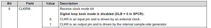

    Looking at your register dump, I noticed PCR.CLKRM is set to 1 which indicates it's being driven by the internal sample-rate generator. It should be set to zero since your clock is being driven by an external source, right?
    Also, is there a pattern to the incomplete data you are getting? Does it appear shifted?
    I'm going to ping  who has more experience with this in case he has more guidance.
