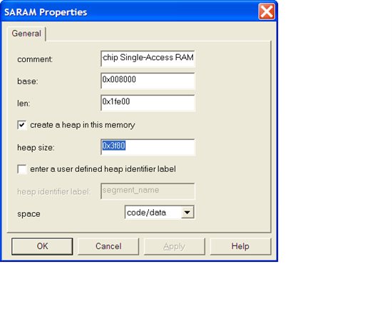

    You are able to increase heap size in BIOS. Open your tcf file under DSP/BIOS Config folder in your CCS. Select SYSTEM-->MEM-->SARAM. Increase heap size.
    Make sure it is word size not byte.

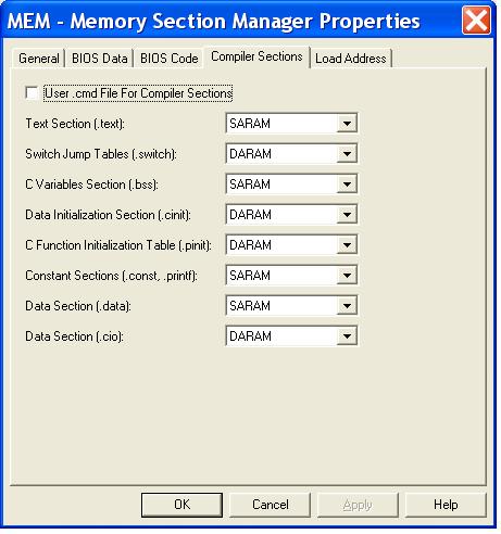

  • Hi Srdjan,
    Your problem may be caused by the compiler section settings in the TCF file. By default, the DSP/BIOS will put the .bss (global variables and static variables section) in the DARAM. In your case, the DARAM is too small for your .bss section. You can change the default setting by right click on TCF à System à MEM Memory Section Manager, then choose Properties à Compiler Sections. The following dialog box will show up:
    Make sure the .bss is using SARAM as shown above.
