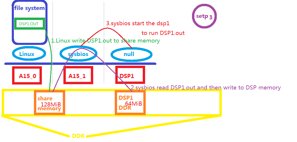

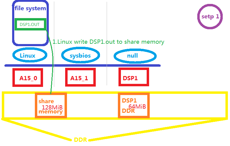

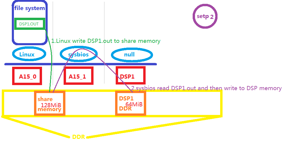

A15_0 running Linux.
A15_1 running Sysbios(jailhouse inmate).
DSP1 or DSP2 just bare loop uart putout.
A15_0 Linux write the dsp1.out to the share memory, then the A15_1 Sysbios read the dsp1.out from share memory,Sysbios elf_load load the dsp1.out to ddr 0x99000000,and start dsp. DSP unning is normal!
But linux will print out (when DSP start):

But when I move the elf_load and dsp_start code to the linux(A15_0) kernel module, just use linux(A15_0) kernel module to load and start dsp, it will not print the error.
