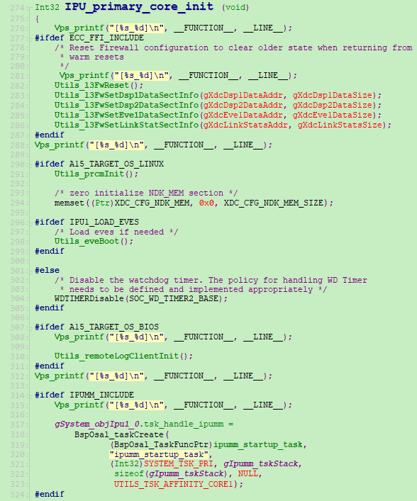

       My IPU_primary_core_init function code:
         Line 276 & line 288 are the two lines that i think show output log to console.

       From which, i think mpuCore0EntryFuncPtr is the pointer to main() in A15, hence the log info should also start from '[HOST]' cpu.
       So i am still so clear of the mening of primary cpu. In my point of view, it's the core which perform app start and management, but not the starting cpu.
