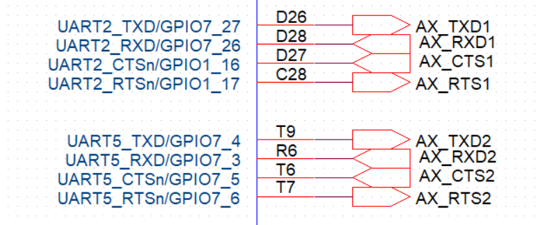

  • Dear Yordan,
    on my board I connected UART2 and UART5 of AM5716 to a connector as you can see in my slices of schematics below:
    (AM5716)
    (Connector P2)
    Through P2, I can connect either UART2 or UART5 to a MAX3232 powered by V3_3D (power supply from PMIC) and have the UART console to my PC. Is this correct?
    In which file do I have to set the UART number in order to use it as console (bootloader, kernel)?
    Best regards
    Francesco
    There are a couple of files you need to modify.
    I. First you need to do the correct pinmuxing in u-boot -> board/ti/am57xx/mux_data.h
    II. Then you should enable the uart in u-boot ->
    1. include/configs/am57xx_evm.h:
    #define CONSOLEDEV "ttyO2"
    #define CONFIG_SYS_NS16550_COM1 UART1_BASE /* Base EVM has UART0 */
    #define CONFIG_SYS_NS16550_COM2 UART2_BASE /* UART2 */
    #define CONFIG_SYS_NS16550_COM3 UART3_BASE /* UART3 */
    2. arch/arm/dts/am57xx-beagle-x15-common.dtsi:
    chosen {
    stdout-path = &uart3;
    &uart3 {
    status = "okay";
    interrupts-extended = <&crossbar_mpu GIC_SPI 69 IRQ_TYPE_LEVEL_HIGH>,
    <&dra7_pmx_core 0x3f8>;
    III. In kernel, you need to modify the dts file arch/arm/boot/dts/am57xx-beagle-x15-common.dtsi:
    chosen {
    &uart3 {
    status = "okay";
    Yordan
