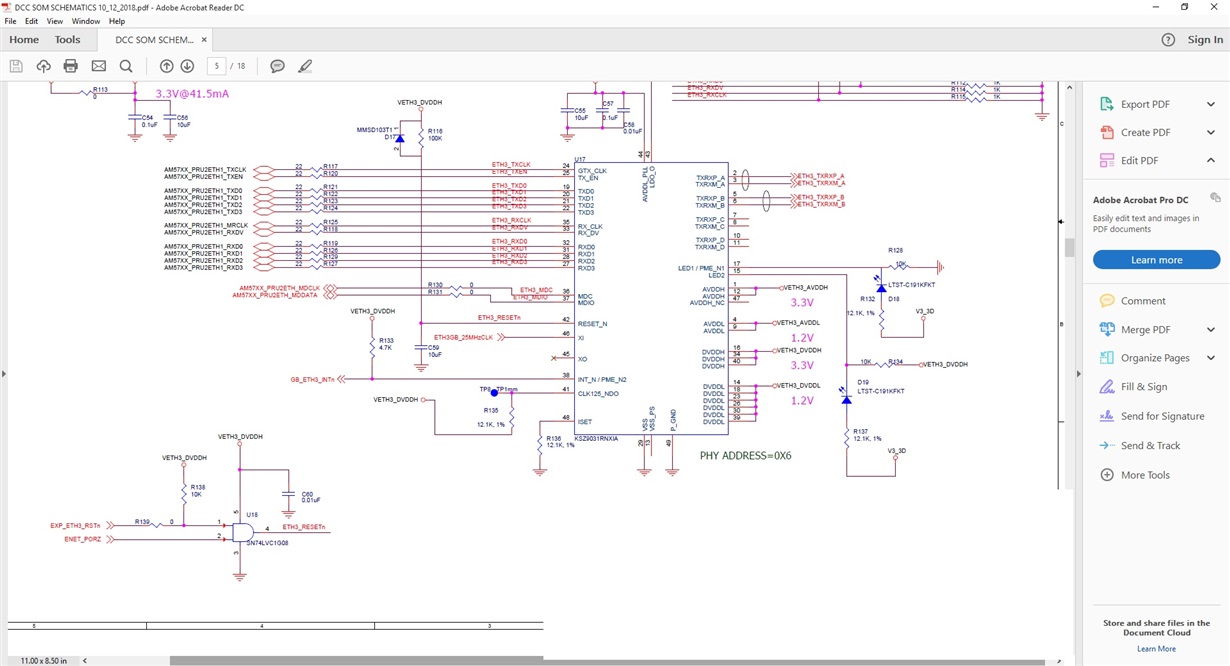

In our custom board we connected PRUSS2 ethernet to micrel ethernet driver IC. we connected rx,tx data lines clocks and ctl signals
I changed the DTS file as below:

    pruss2_eth0_phy: ethernet-phy@5 {
        reg = <5>;
    dual_emac_res_vlan = <3>;
    pruss2_eth1_phy: ethernet-phy@6 {
        reg = <6>;
    dual_emac_res_vlan = <4>;
we used physical address of 5 and 6

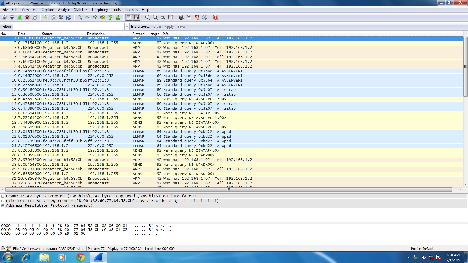

  • hello Nick,
    after installing modules our problem solved.
    now I am able to see eth0,eth1,eth2,eth3 after giving ifconfig command
    but unable to ping eth2 and eth3
    please suggest what to change
    Kumari
  • Hello Kumari,
    Please take a look at the Ethernet Triage Checklist for ways you can collect debug information for us to proceed. In addition to the suggestions there, I would be curious to see ifconfig -a.
    Are you connecting all of your ports to the same network? If so, try connecting only a single port and checking if you can ping it.
    Nick
  • Hello Nick,
    1) Kernel Version: Linux am57xx-evm 4.4.32-gadde2ca9f8 #1 SMP PREEMPT Mon Jan 14 14:41:35 IST 2019 armv7l GNU/Linux
    2) File System: am578 SDK ti-processor-sdk-linux-am57xx-evm-03.02.00.05-Linux-x86-Install.bin based file system
    3)Board: Custom Board
    4)Console Log: attached as file  name console log

  •  Hi Nick,
    we assigned IP address Manually
    We connected only one port at a time
    the Wireshark capture is attached herewith
  • Hello Kumari,
    Your ping is looking for 192.168.1.0, but eth2 in your previous post was assigned 192.168.1.1, so it would not respond to that ping.
    Could you confirm that you are pinging the correct address? What happens if you try to ping 192.168.1.2 from your board?
    Nick
  • Hello Nick,
    we have given correct address only
    after giving ping we are getting the following message.
    PING 192.168.1.0 (192.168.1.0): 56 data bytes
    Kumari
  • Hello Kumari,
    We do not suggest setting any of your IP addresses to x.x.x.0 or x.x.x.255 - those are typically broadcast addresses.
    I am having trouble piecing together a complete picture of what you are doing. Please attach your console output as a .txt file along with the wireshark captures. I am curious to see both a working case (CPSW) and a non-working case (PRU).
    Nick

    Hi Nick,
    I am attaching the CPSW and PRU ethernets log files
    Kumari
  • Hello Kumari,
    Link is up... link is down... link is up... link is down typically indicates that there are hardware issues with the PHY. The fact that your eth2 connection negotiated to 10Mbps/Full also point to a PHY issue.
    What revision of what board did you use as your template? Could you provide a screenshot of the schematic of the PRU's PHY?
    In current TI device trees we specify reset-gpios and reset-delay-us within the &pruss2_mdio (see am571x-idk.dts for an example). I am not sure if our examples from PLSDK3.2 included reset information, but that might be something to look at.

     Hello Nick,
    DTS file and schematic screenshot are attached
    Kumari
  • HI
    Please review and comment on the schematic
    Is there a possibility to change PRU MAC interface from MII to RMII
    we are using KSZ9031 (RMII/RGMII interface) with PRU Ethernet MAC (MII interface).
    The link is established. Rx clk is observed but there is no tx clk
    is there any compatibility issues between MII and RMII interfaces. if there , what are the changes to be done in pru_rproc.c to make them compatible?
  • I am sorry for the delayed response.
    I am not a hardware expert, but you do seem to have the reset signals that I was looking for. I cannot comment on anything else on the schematic. From a Linux support side, I am not sure there is much more I can do to support that version of Linux.
    My only other advice would be to follow-up with the PHY manufacturers and make sure that everything in hardware looks ok to them.
    Nick
