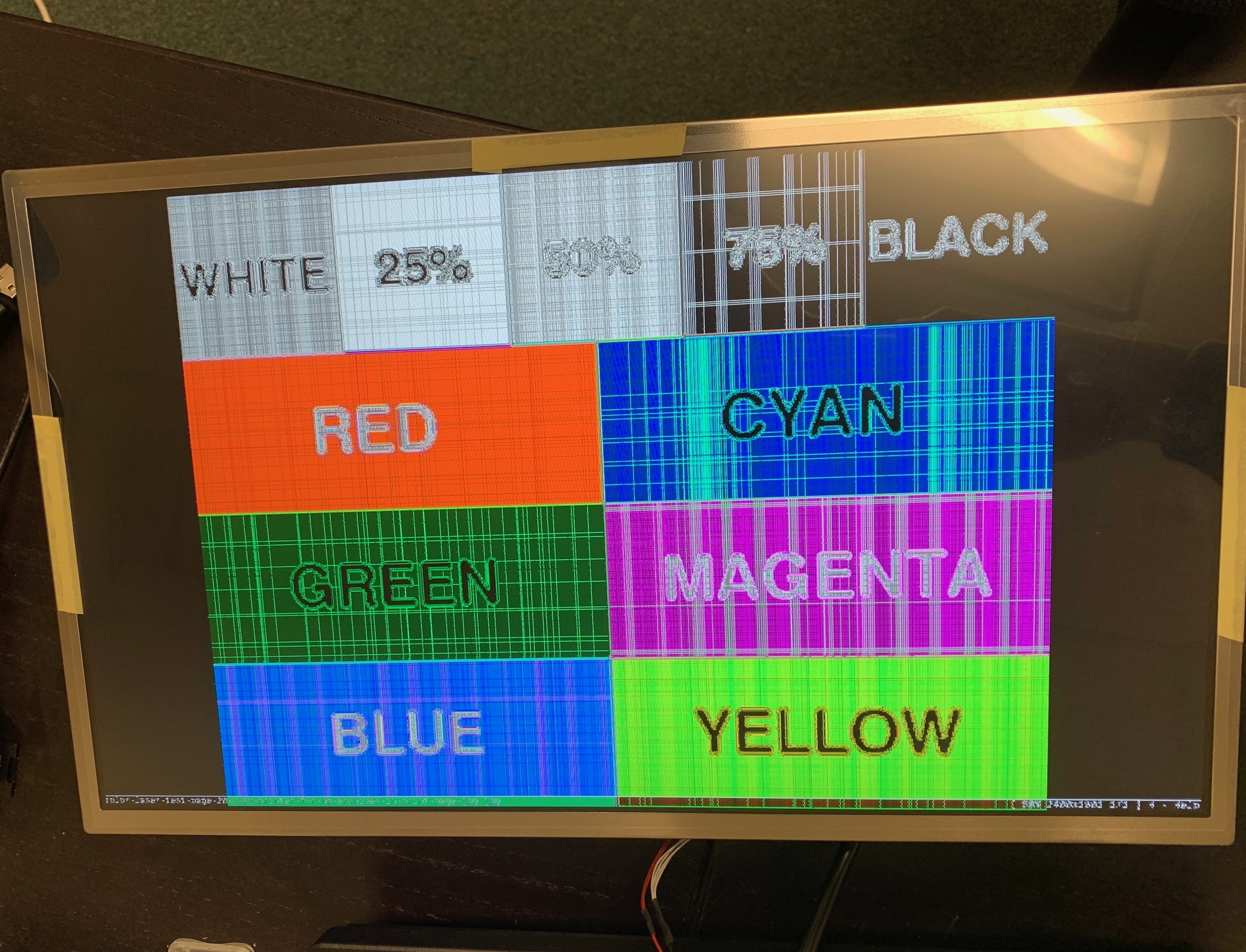

On my AM5708 custom board with dual LVDS attached to a FHD panel, I am using "fbi" tool to display images onto the framebuffer. Mostly it's working right, but as you can see it has horizontal and vertical lines and colors seem toe be off as well. Can someone suggest avenues to debug this?

  •  I notice any color that uses green has issues (check the above table against the original photos attached).

    Also, I'm not using dual display (as in 2 different outputs). I'm using dual LVDS to drive a single LCD panel at FHD resolution. Dual LVDS (and not single LVDS) is required for FHD.
    I believe the connection between the SoC and DS90C387 is correct. When I drive a smaller panel (1280x1024), using single LVDS, there is no color issue.
    Let me reiterate, DS90C387 is responsible for outputting single and dual LVDS outputs. Between the SoC and DS90C387, it is 24bit RGB.
  • Thanks for the explanation. The fact that you are able to drive the display correctly for smaller resolution, it makes me feel that this may be a signal integrity issue.

  • Hi Tom, thanks for following up. I believe there is a hardware issue. The output format from DS90c387 doesn't match with the input format of my display.
    Below is the output timing diagram from DS90C387. Essentially, every bit in the RGB data needs to get shifted by 2 places to the left. Is there a way to change the output format in Linux? I'd like to work around this issue in software, before making a change in the hardware.
  • Adam,
    You stated: "The output format from DS90c387 doesn't match with the input format of my display".  The DS90C387 is a standard serializer device that converts parallel RGB data to serial streams that are OpenLDI compliant.  I do not see how changes in the RGB data coming from the AM5708 can fix your serial data format issue.  It appears to me that you either need to choose a different serializer that is compatible to your display OR choose a display panel that is compatible to the OpenLDI serial interface which is available from the DS90C387 serializer.
    Previously you mentioned that the DS90C387 and your display panel communicated correctly at lower resolutions.  Can you explain this?
    Tom
  • Hi Tom, thanks for the respnse. I can't find any mention of OpenLDI from the display datasheet. So I should assume it's not.
    Previously I stated the colors look good as long as I set my display manager (Weston) to use RGB565, not full RGB888.

  • This is our prototype board. The next revision is using a different LVDS driver. I just wanted to make sure the panel is good. Thanks for the help!
