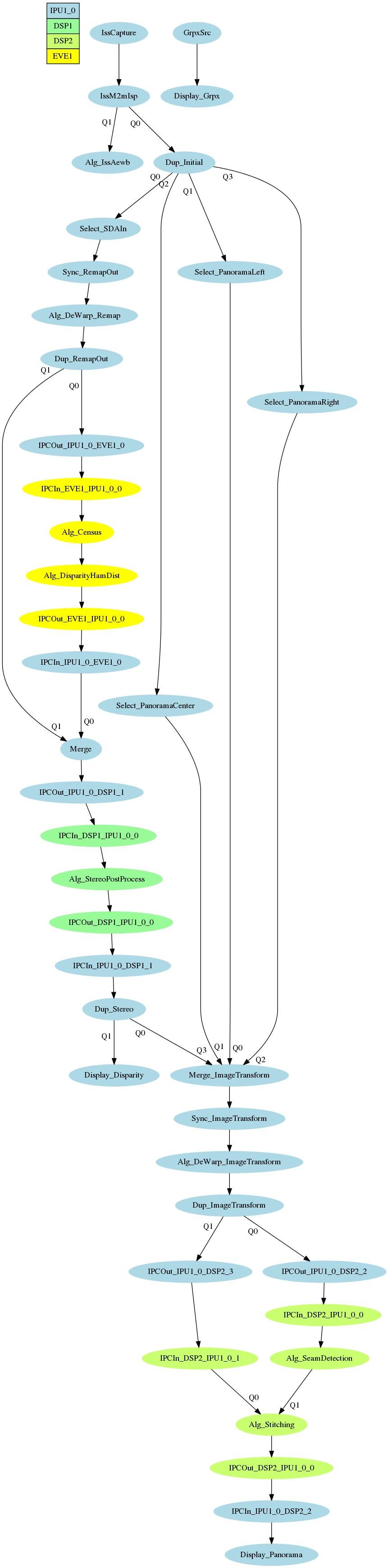

I am trying to create a custom usecase in the vision SDK that captures video input from 4 image sensors at 720x1280x60fps, but I have only been able to get about 38 fps through the ISP.  What is the maximum throughput of the ISP on TDA2Px?  Is the ISP's clock speed increased in OPP_HIGH mode, or is there any other way to speed it up or check its current speed?
Mike
  • Hi Mike,
    For 1280x720@60 fps 4CH, it should be possible for ISP to perform in real time. ISP on TDA2px runs at 350MHz, so even if we consider 30% blanking overhead, it should be still be able to run all four channels at this fps.
    Could you please share your performance stats from the console? Lets check if this is because of the ISP or some other module in the chain, which is slowing down entire chain.
    Rgds,
    Brijesh
  • Hi Brijesh,
    Thank you for your reply and the clarification. The usecase we are running is fairly complex, so it is definitely possible that something else is slowing down the chain. We are essentially running the Rearview Panorama usecase from VSDK 3.5, but it has been modified to run on a TDA2Px and use a different camera with different image quality tuning. I've attached an image of the chain, as well as the performance statistics from the console.  As you can see around line 257-260 of the stats, the frame rate is reducing from 60 fps to 38 fps at the ISSM2MISP link. Any thoughts on other components that may be causing the slowdown?  Is it possible that we are limited by the DDR bandwidth?
    Mike
