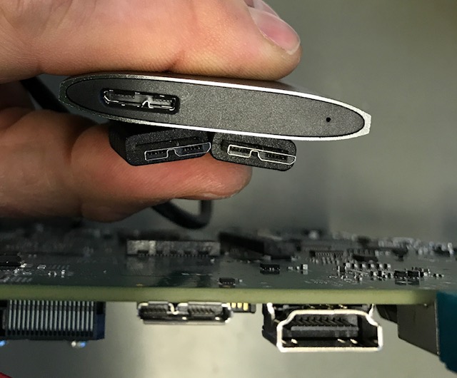

  • Hi again!
    My SSD connection looks like this:
    (In my Hand: SSD and cable, below: Connection on EVM)
    What about the issue that the LED of my SSD never light?
    It is not powered (no 5V), so there is no chance for enumaration anyhow.
    .... I will take a look in to the schematic and see if the 5V are at the connector.
    (Any DIP-Switches or GPIO neccessary? You didn't answer this question... So I've to ask again ;-) )
    Pin 1 of the micro B Jacket: There is no 5V voltage present...
    Thanks... Marco.

  • Additional information:
    I am not able to "force" Host Mode:
    root@dra7xx-evm:~# echo "host" > /sys/kernel/debug/48890000.usb/mode
    root@dra7xx-evm:~# cat /sys/kernel/debug/48890000.usb/mode
    OTG
  • I don't see the xhci host controller getting probed. Since this USB instance is configured in OTG mode in the kernel device tree file, we could force it to switch to Host mode. So , I suspect the issue to be due to the ID pin.
    Looks like the USB cable is not grounding the ID pin. There is a way to force the ID pin low on DRA7-evm. It can be done using DIP switch SW1 switch 2. Just flip it to the ON position and see if you get GPIO ID interrupt and XHCI host controller getting probed.
    The Voltage of VBUS pin of USB1 will be zero if usb cable is not inserted as it is in device mode. The moment you plug in the connect the OTG compliant able (which has ID grounded) you should see VBUS on USB1 as it now has entered in host mode.
    So if we don't see the voltage on VBUS pin, then most probably the usb cable used to connect the SSD drive is not OTG compliant and It will not work on the EVM.
    -Praveen
