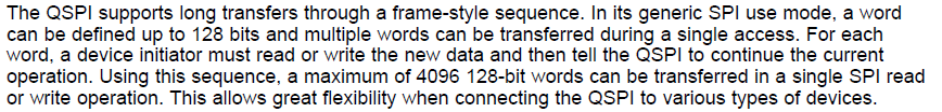

How much code can the AM437X processor boot from QSPI at the time.  the document does not describe.
