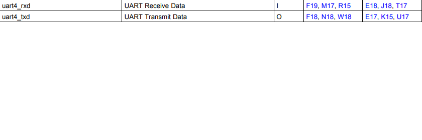

Hi SIr
We followed the DTS setting to set UART4 and didn't measure the signal from TX pin
uart4_pins: pinmux_uart4_pins {
pinctrl-single,pins = <
AM33XX_IOPAD(0x968, PIN_INPUT_PULLUP | MUX_MODE1) /* UART0_CTSn.uart4_rxd */
AM33XX_IOPAD(0x96c, PIN_OUTPUT_PULLDOWN | MUX_MODE1) /* UART0_RTSn.uart4_txd */
&uart4 {
pinctrl-names = "default";
pinctrl-0 = <&uart4_pins>;
status = "okay";
/* dmas = <&edma_xbar 32 0 9
&edma_xbar 33 0 10>;
dma-names = "tx", "rx";*/
please advise if there is any issue about the DTS setting
thanks
