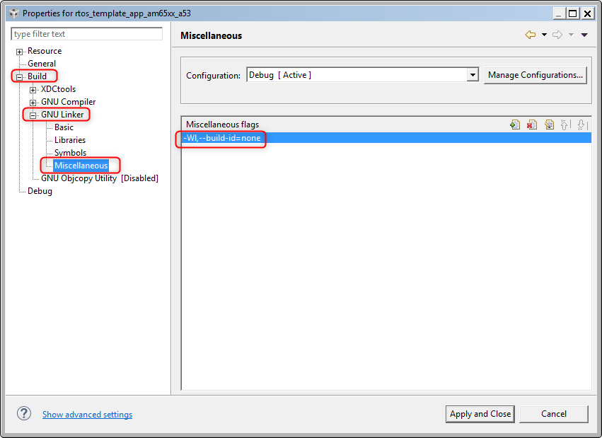

  • Thomas,
    I think we have it figured out.  From what I understand, there's an issue in GCC where things get corrupted when generating a build-id but then later declaring it as NOLOAD.
    The simplest workaround (in my opinion) is to just disable the build-id feature altogether.
    • Go to CCS project properties
    • Go to Build -> GNU Linker -> Miscellaneous
    • Click '+' to add a miscellaneous flag.
    • Enter -Wl,--build-id=none as your flag.
    Here's a screenshot:
    I hope this hasn't been causing you too much grief.  Sorry to keep you waiting so long for a fix.  It wasn't easy to figure out!!!
    FYI, the alternative fix is to remove the NOLOAD in linker.lds for the template app:
    - .note.gnu.build-id (NOLOAD) : { *(.note.*) }
    + .note.gnu.build-id : { *(.note.*) }
    My own preference is to fix this at the command line, though if you had any inputs on either of these as being preferable to the other, I'd be interested to get your perspective.
