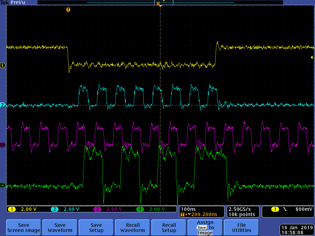

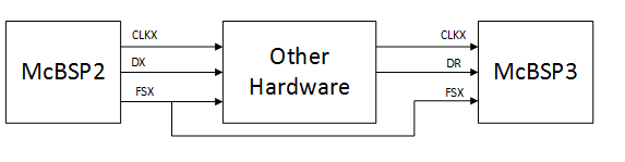

I am using McBSP2 and McBSP3 on a DM3730 processor to send data to and from another hardware device.  My hardware configuration uses McBSP2 as a master to transmit data to the other device, and McBSP3 as a slave to receive data from the other device as per the attached diagram.  Currently the hardware between the McBSPs is gating the clock to McBSP3 so that it is only present when FSX is active - as per the attached scope capture. Ch1 = FSX, Ch2 = CLKX input to McBSP3, and Ch3 = CLKX output from McBSP2.  FSX is configured for active-low, 8-bit frames, 8-cycle pulse width.  Data and Frame sync are sampled on the rising edge.
In this configuration we cannot receive data from McBSP3 - we can transmit any number of bytes from McBSP2, but the McBSP3 DRR register is empty afterwards.  If we connect the free-running McBSP2 clock directly to McBSP3 and make no other HW or SW changes, we can receive data correctly.  Can you help us understand why we are not receiving data?
1. In our configuration McBSP3 never sees FSX inactive (high) on a rising clock edge.  Does the McBSP need to sample frame sync inactive before sampling it active in order to recognize the start of a frame?
2. In our configuration McBSP3 CLKX stops after the end of the frame, and doesn't resume until the start of the next frame.  Are any CLKX pulses required after the end of a frame to move the received data from the shift register to the DRR register?

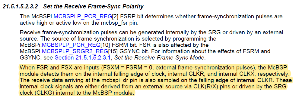

    The designer referred me to the below section from the DM3730 TRM.
    The second paragraph states that the frame sync inputs are sampled using the CLKR_int/CLKX_int clocks. This leads him to conclude that the clocks must be running to sample the frame syncs.
    Mark

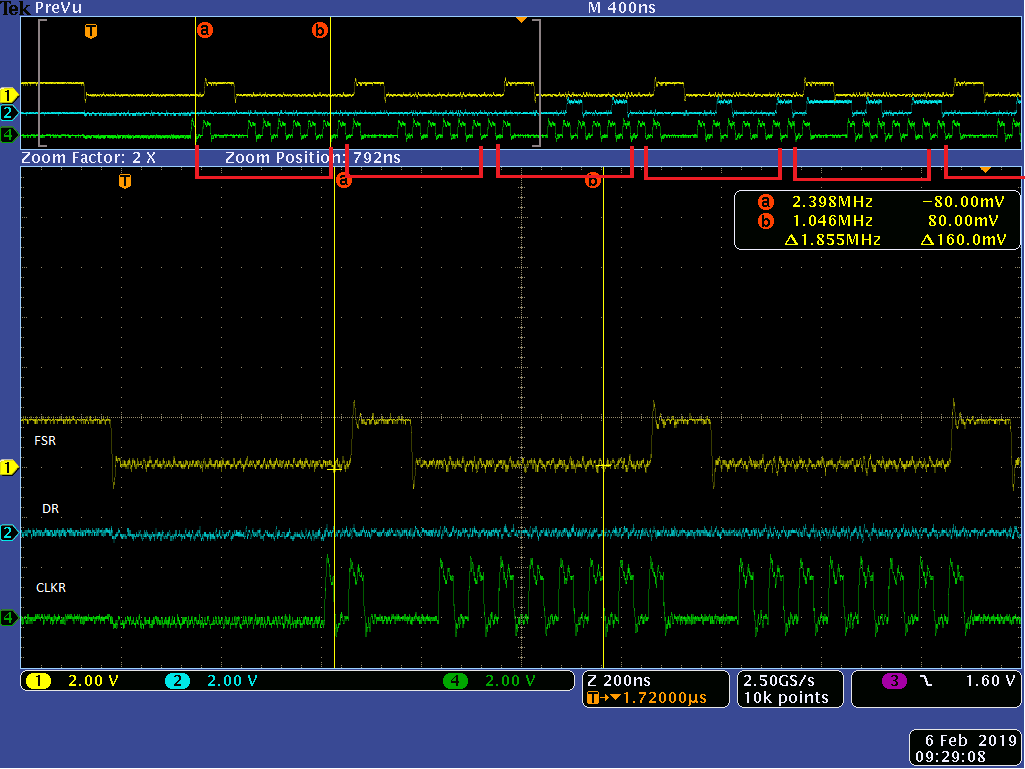

  • Mark,
    Thank you for the followup.  I was able to resolve the original issue I posted about by making a hardware change to provide the free-running clock to the slave McBSP.  However, we are having a similar issue with another McBSP receiver where the data pattern is slightly different - see screenshots below.  In this setup the clock to the slave McBSP is gated (I suspect this may be the problem based on the info you provided above from the designer).  The receiving McBSP is configured for slave, falling edge, frame sync active low, 8-bit word length.  Based on TRM 21.4.4.3 and Figure 21-43, I expected the word to begin on the first CLKR falling edge (first picture cursor a) and end on the 8th CLKR falling edge (first picture cursor b) and then continue receiving the next word at the next CLKR falling edge.  I expected the McBSP to ignore the "unexpected receive frame sync" on each CLKR falling edge until the full word has been received.
    What we observe is that the slave McBSP appears to ignore the first two CLKR pulses and begins clocking in data at the next CLKR pulse after the FSR transition (second picture cursor a).  This results in a bit shift in the received data, which I tried to show with the red highlight at the top of each picture.  The data actually in the McBSP receive buffer is shown in the second picture, the data I expected is shown in the first picture.
    We read the errata you provided above and provided several CLKR pulses to the slave McBSP before beginning the data transfer shown in the pictures, but this did not fix the issue.  (Without these extra pulses, the McBSP also did not receive the first full byte of data, so we know that those pulses are getting the slave McBSP in sync.  I didn't see any explicit statements in the TRM that a free-running clock is required in slave mode, although all of the example waveforms do show this.  I am currently testing a hardware change for my second setup that would provide the free-running clock.
    Steve
  • Hi Steve,
    Its probably due to the lack of a free-running clock again. But its surprising that its the same 2-bit shift that is mentioned in the errata.
    Give the hw change a try, and let me know if you want me to follow up with the designer about it.
