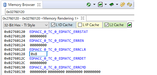

My customer noticed that MMRAERR on EDMATC_ERRSTAT register was sticky even if they clear the bit via EDMATC_ERRCLR register.
I recreated the same problem on my EVM, see below:
1. launch CCS and connect to C66 core with default gel file and then open memory browser. If you navigate EDMATC_ERRSTAT register, MMRAERR has been set by default. Not that EVM has been powered with No Boot configuration.

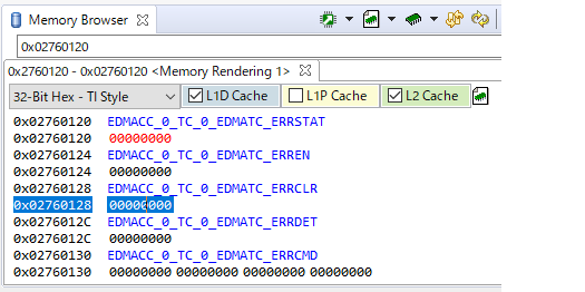

2. Try to clear the bit via EDMATC_ERRCLR register
3. The bit looks cleared ...

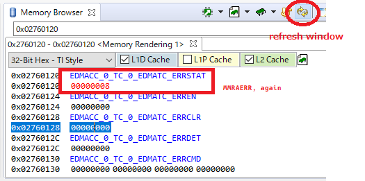

4. But if you update the window, the error raised again.

    I tried the same setup of a K2G EVM in no-boot mode and default GEL and used C66x core to poke 0x2760120, 124 and 0x128 register.
    - 0x120 is read-only and I saw it has BIT 3 set by default, I can't write
    - 0x124 I can write 1 to BIT 3 or write 0 to BIT 3
    - 0x128 I tried to write 8 to clear the BIT 3 on 0x120, it has no effect (different from your observation)
    - 0x12c (ERRDET) this is always 0 and it didn't record anything
    This BIT 3 of ERRSTAT is sticky, I have no way to clean it. The question is, with this bit always set, does this cause any problem to the EDMA transfer? How do you plan to use this bit?

    This is a known deficiency in the EDMA3 IP , you will find some older posts on this on other devices and it applies to K2G too
    e2e.ti.com/.../104441
    e2e.ti.com/.../292964
    It is likely that when you pull the memory window in CCS, you are also accessing some reserved configuration address in TC memory map, that is causing this error.
    In non CCS environment, I do not think you will see this error , unless the program code is accidentally accessing config memory map in TC that is marked as reserved etc.

  • Hi Kawada-san
    Here is a snapshot from internal spec
    In addition, both functional and emulation accesses to invalid address ranges will cause the MMRAERR
    status bit to be set. An interrupt will be generated if enabled. Note that this is not ideal as normally a user
    would not desire the an error to be logged for accesses to be generated by emulation accesses. This issue
    can be avoided by:
    • user can mask reserved address ranges in CCS such that emulator will never access reserved
    range
    • user can disable interrupt generation for MMRAERR bit if desired (of course, this will mask
    errors for functional access)
    Essentially CPU accesses in normal/functional mode or emulation mode (e.g. CCS access - emulate reads) to areas within CC or TC memory map that are reserved, will cause the MMRAERR bit to be set.
    So in your case when customer is reading TC memory map in memory window, they will see this bit get set.
